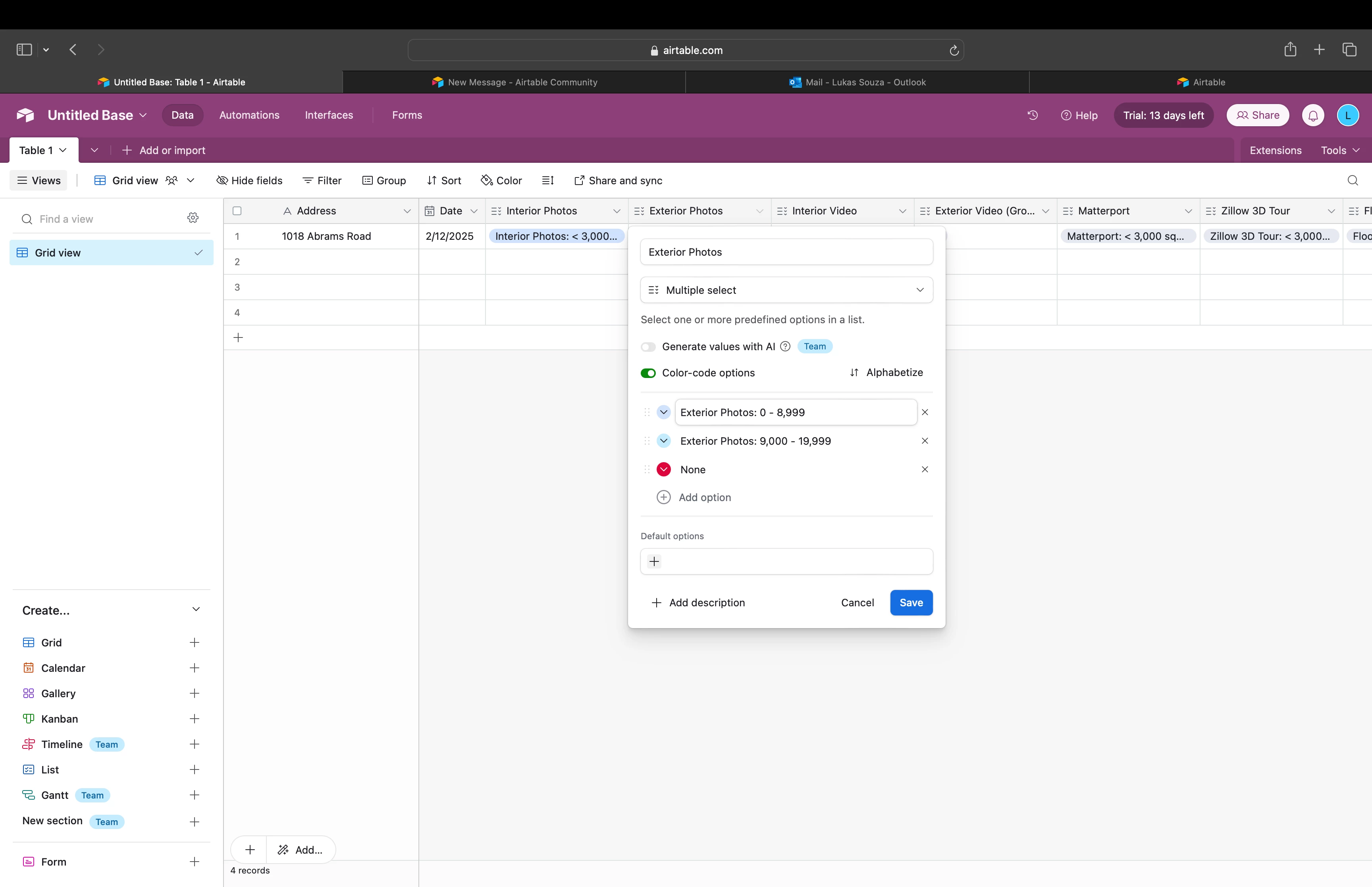

I am trying to build a table to calculate pricing. But, every column (which is its own product) has different price points under it, based on square footage. How can I set up a formula that will calculate each drop-down option (multiple selection), per column and total that up at the end? See screenshot for reference
First column is interior photos. There are four potential options in that field, so I need a formula that will calculate based on the selection I make in each column. And the same goes for every other one.

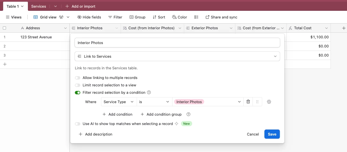

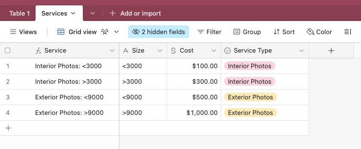

Create a second table that will contain all of the services offered. Let's call it "Services." The primary field is the "Service," another field is a currency field called "Cost." You should additionally add a single select field to categorize what the service relates to (ie. Interior Photos, Exterior Photos, etc), let's call it "Service Type." In the example I made below, I made the "Service" field a formula field that creates its name based on the Service Type and Size fields.

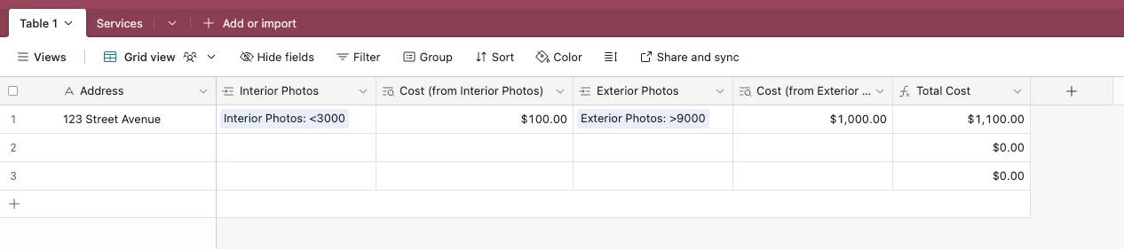

Then in your first table, you can create a linked record field for each service type. Configure each field so that only fields of that service are linkable. For each field, add a lookup field for the Cost.

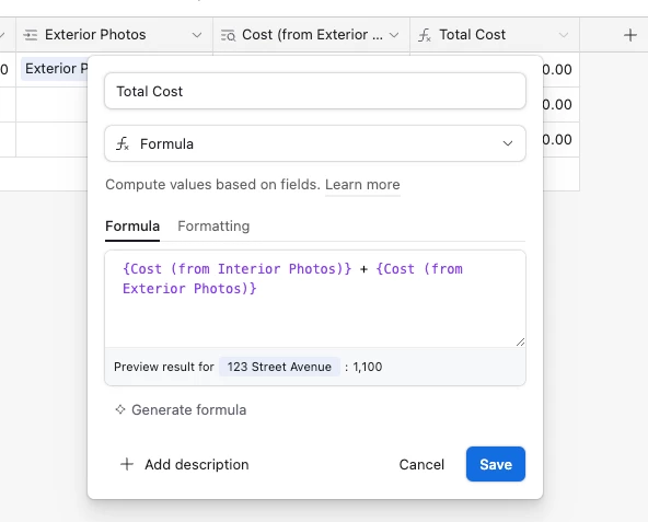

Then, you can create a formula field that adds all of the lookup fields together to get your final cost. You can format the formula output as a currency so that it shows in dollars.
