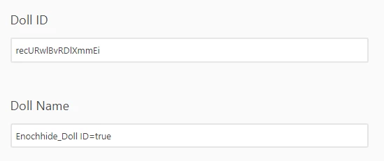

However, the part to hide the record ID is not working. This is what happened to the form:
As you can see, the "Doll Name" area has the formula to hide the record ID in it. 🤔 🤔
I tried doing it exactly like the video and only having "(Doll Sculpt)", but it said there was an error with the formula and I was forced to use "({Doll Sculpt})". Could this be the issue?

Best answer by marks
Looks like you want to change
&'hide_Doll%20ID=true'
to
&'&hide_Doll%20ID=true'
The first & is for the Airtable formula to concatenate (combine) the components and the second & is to go into the URL

Fantastic, that worked!
However, I tested this out with the automation and realized that it deleted the original table data if the relative update form field is left blank, which makes sense since it directly replaces all the data in that record. That won't work for me, so it is back to square one.
