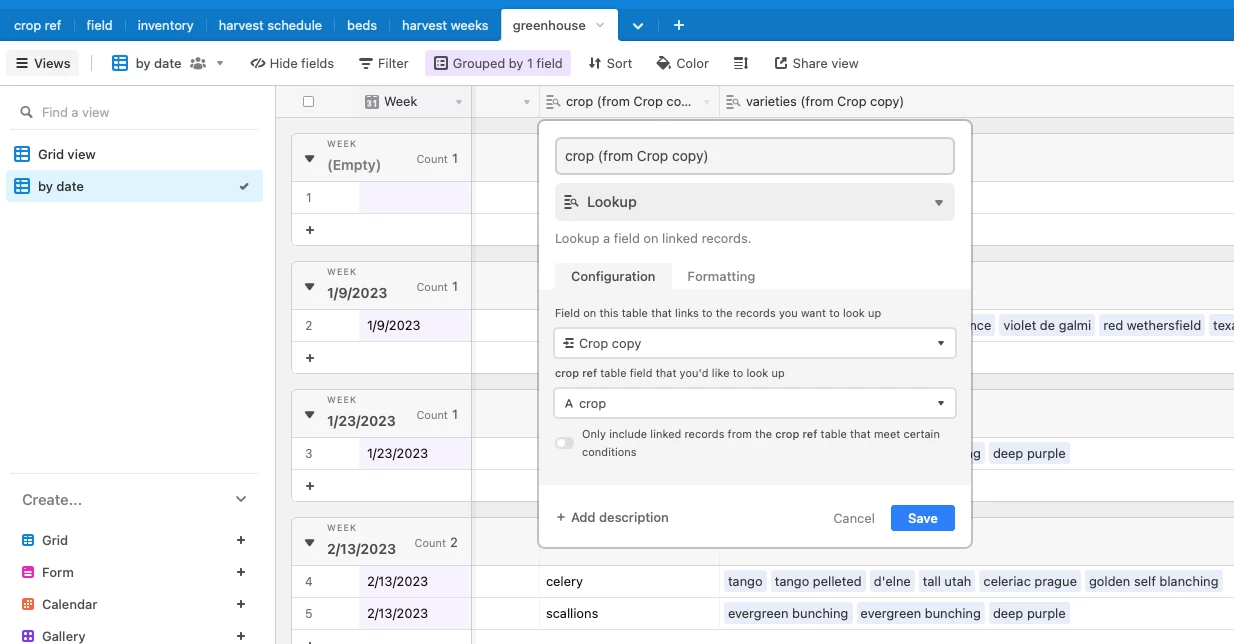

i think i might be linking to the wrong table? or formula needed? see attached...I can't find where "crop copy" is?

Crop Copy means that you duplicated the Crop field at one point and then forgot to rename it. Happens to me all the time.

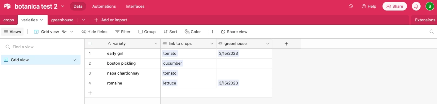

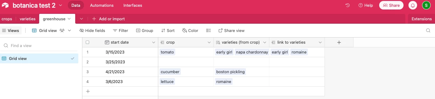

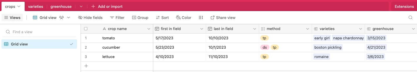

I really appreciate the help so far, but i'm not a programmer but I still feel like I'm not getting the results i want so i changed my approach slightly. (I did get the concatenate to work, however)
  1. crop table (crop name, field dates, general info)
  2. varieties (linked to crop name to associate the crop with it's varieties) also contains inventory numbers.
  3. greenhouse (currently a list of crops and their planting dates
from the greenhouse list, i want a place to pick which variety i ended up planting from my available inventory (in the variety table). i was able to get the available varieties to show, but can't figure out to select just one? i can also create a linked field that i can see ALL the varieties, but I just want the ones associated with the particular crop. (so i don't pick romaine tomatoes)
it seems to me when i try to grab a linked record, I should be able to type in "tomato" to find all of the tomatoes, but i think my linking is wrong and it gets confusing when airtable automatically adds fields to source tables.

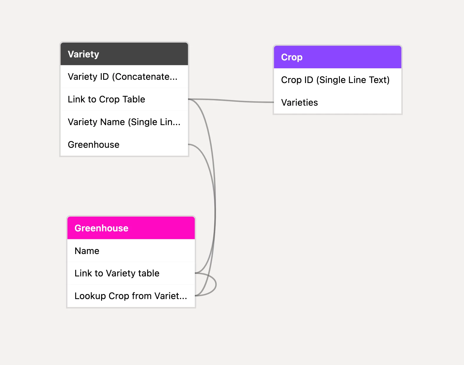

I think you’re getting stuck on linking the Crop table to both the Varieties and the Greenhouse tables. Crop links to Varieties and Varieties links to Greenhouse.
I’m  not seeing the concatenate formula in the screenshots you sent, and that’s the thing that is going to allow you to type Tomato in your Greenhouse table and be able to choose from the Tomato varieties that you have on hand. So you need to duplicate the first column of your Varieties table, rename the first column VarietyID and put the concatenate formula in that column. Otherwise it’s not going to work.

And I just realized that I deleted the link to the base above so here's a new one.: https://airtable.com/shrnkikzT9dL8zwyx
