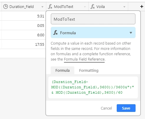

I have a solution, but first to note, the MOD() function doesn’t want the ‘m’, it only needs the input and divisor. Also, this solution would need an additional MOD function if the duration goes longer than 24 hours, as it stands a duration of 27:37 would come out as “Time: 03:37”
first MOD it like this to make text

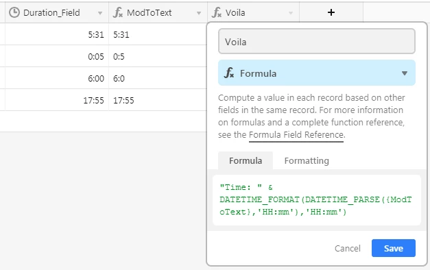

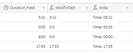

then some fancy formatting like this to get it back to a date, and format the date to just (24)hours and minutes
this can all be combined into one field, its just broken up for ease of understanding.
(Duration_Field-MOD({Duration_Field},3600))/3600&":"& MOD({Duration_Field},3600)/60
"Time: " & DATETIME_FORMAT(DATETIME_PARSE({ModToText},‘HH:mm’),‘HH:mm’)
