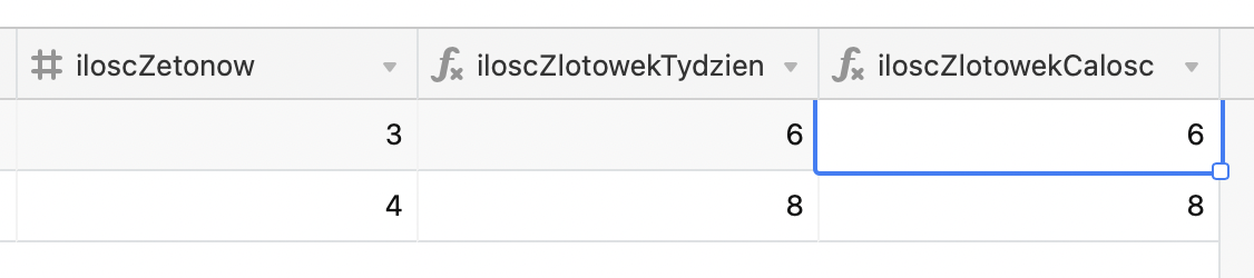

on “IiloscZlotowekTydzien” i have formula =iloscZetonow*2.
Field iloscZlotowekCalosc I need to update each week by adding iloscZlotowekTydzien to iloscZlotowekCalosc.
Any idea how to do it?

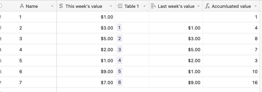

Hi Maciej, I’m not too sure whether I understand the problem correctly. Could you tell me which of the two below is the one we’re trying to achieve please?
Option 1:
We only want last week’s value, where it would look something like this:

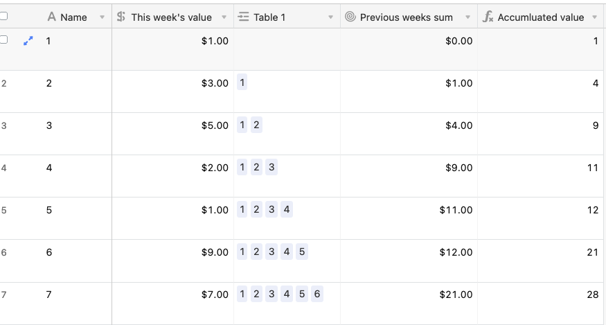

Option 2:
We want all of the previous week’s values, added together:
Option 1:
Option 2:

Thank you @Adam_TheTimeSavingCo. I have Option 1 in my mind.

Roger that. The idea is to:
  1. Link the this week’s record to last week’s record (the Only last week field)
  2. Create a lookup that shows us what the value was last week (the Last week's value field)
  3. And sum the values we need Accumluated value
If you’re alright with it, you can do this manually by linking last week’s record to this week’s record.
If you want it to be automated, then you’ll have to create a system to find last week’s record by linking all of your existing records to one record and using max(values).
I’ve updated the original base with just such a system and automation. I’m unsure if this is what you’re looking for; let me know if it is and I’ll answer any questions you have.
