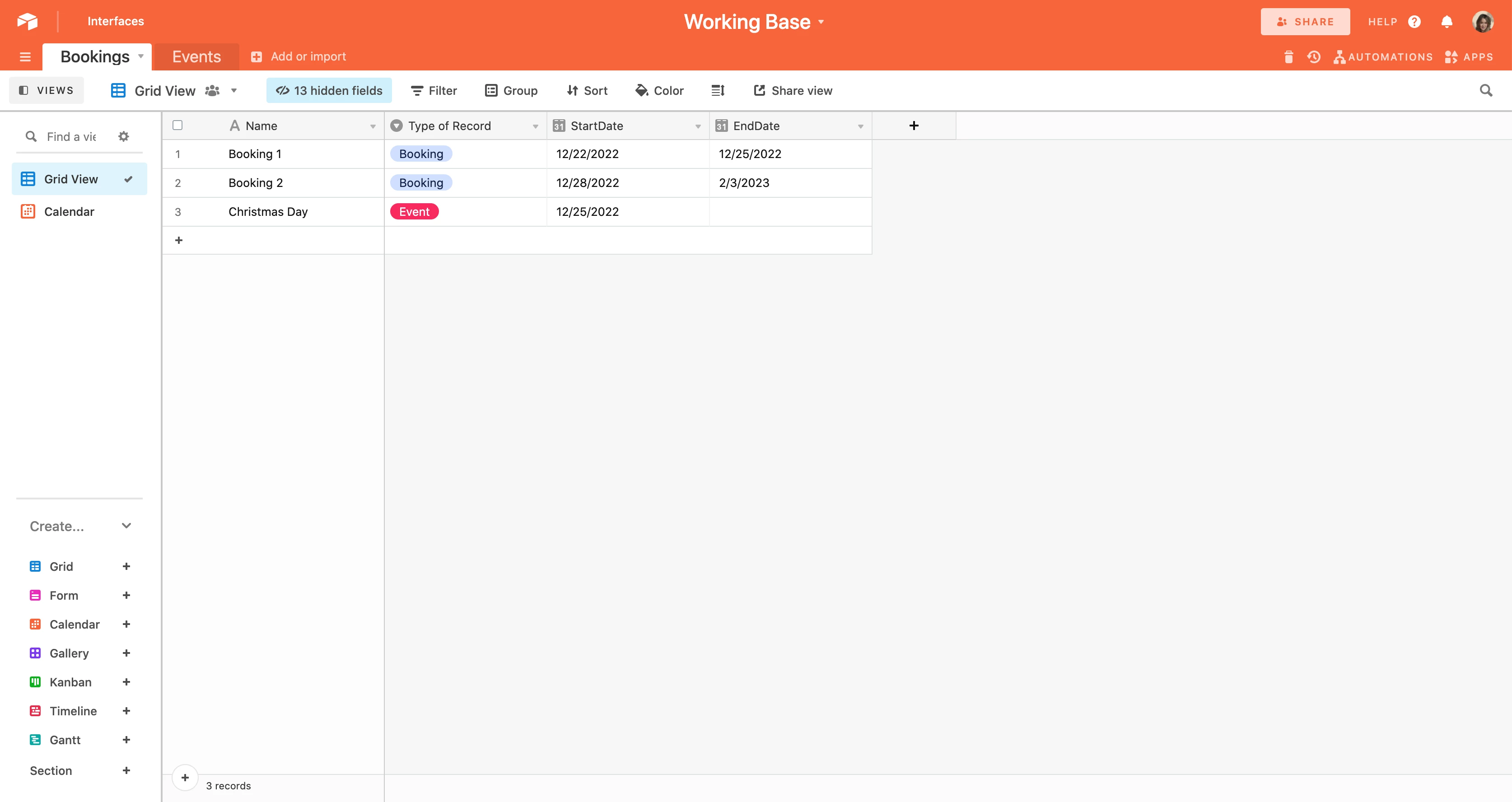

This is definitely a tricky one! And before providing a potentially over-complicated solution, would leveraging the calendar multiple date function work for you? It won’t provide you a field that specifically states what event overlaps the booking, however it will be able to visually represent this really well!
Simple Solution
For example, have just one table that has all your Airbnb Bookings and External Events and differentiate between them by labelling each with a “Record Type” single select field.
Then the Calendar view will look like this and you will be able to see any Events and Bookings that overlap.

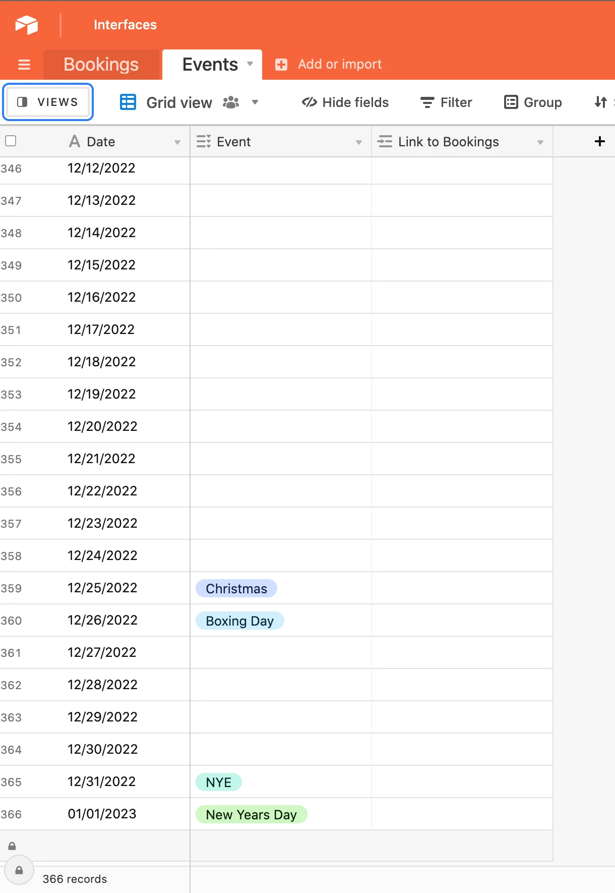

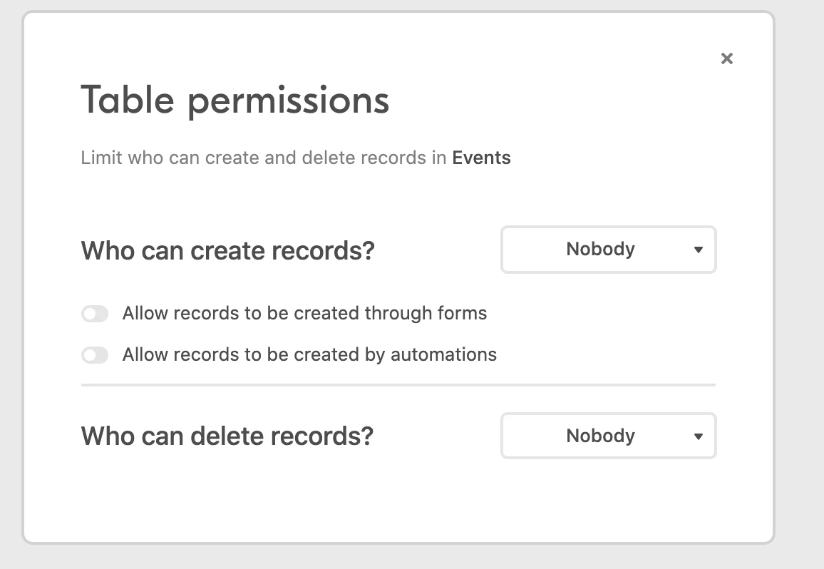

Firstly, like you mentioned you will need to create a new table that houses all of your Event Dates. However, there can only be one record per date. So what I would recommend is pre-creating all the records/dates you need, as well as editing the Table Permissions to prevent record creation/deletion until you need to add more dates (You will still be able to add Events to each date) And you will get something like this:

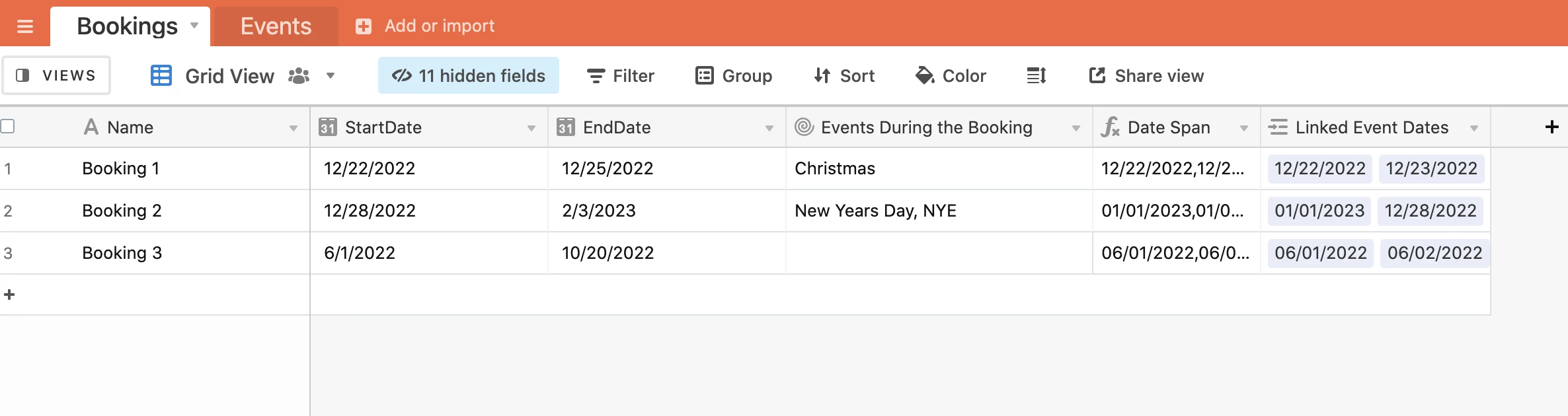

Next go back to your Bookings table and create a “Date Span” formula field to give you an array of all the unique dates between check in and check out. I used @W_Vann_Hall 's brilliant formula for this, you can see the full details and explanation in the original post here
Then just create a Linked Record between the 2 tables, and copy and paste the “Date Span” field into the “Linked Event Dates” field.
Lastly create a rollup field to show unique Event Names in your Booking table.
