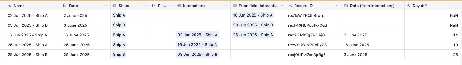

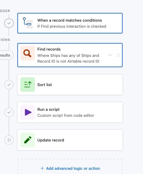

Does this look right?  I’ve set it up here for you to check out.  We can’t use formula fields for this so I ended up using a linked field + automation to handle it, and the automation looks for the latest ‘Interaction’ record for the selected Ship and links it together
The caveat here is that it assumes the record you’re running it on is always the latest record though, i.e. if you ran the automation on a record for 1 June, and you had another unlinked record for 2 June, then it’d link to the 2 June one instead
The automation’s kind of tricky to set up and requires a Scripts action; you can duplicate the base into your own workspace to copy the automation settings so you should be good!

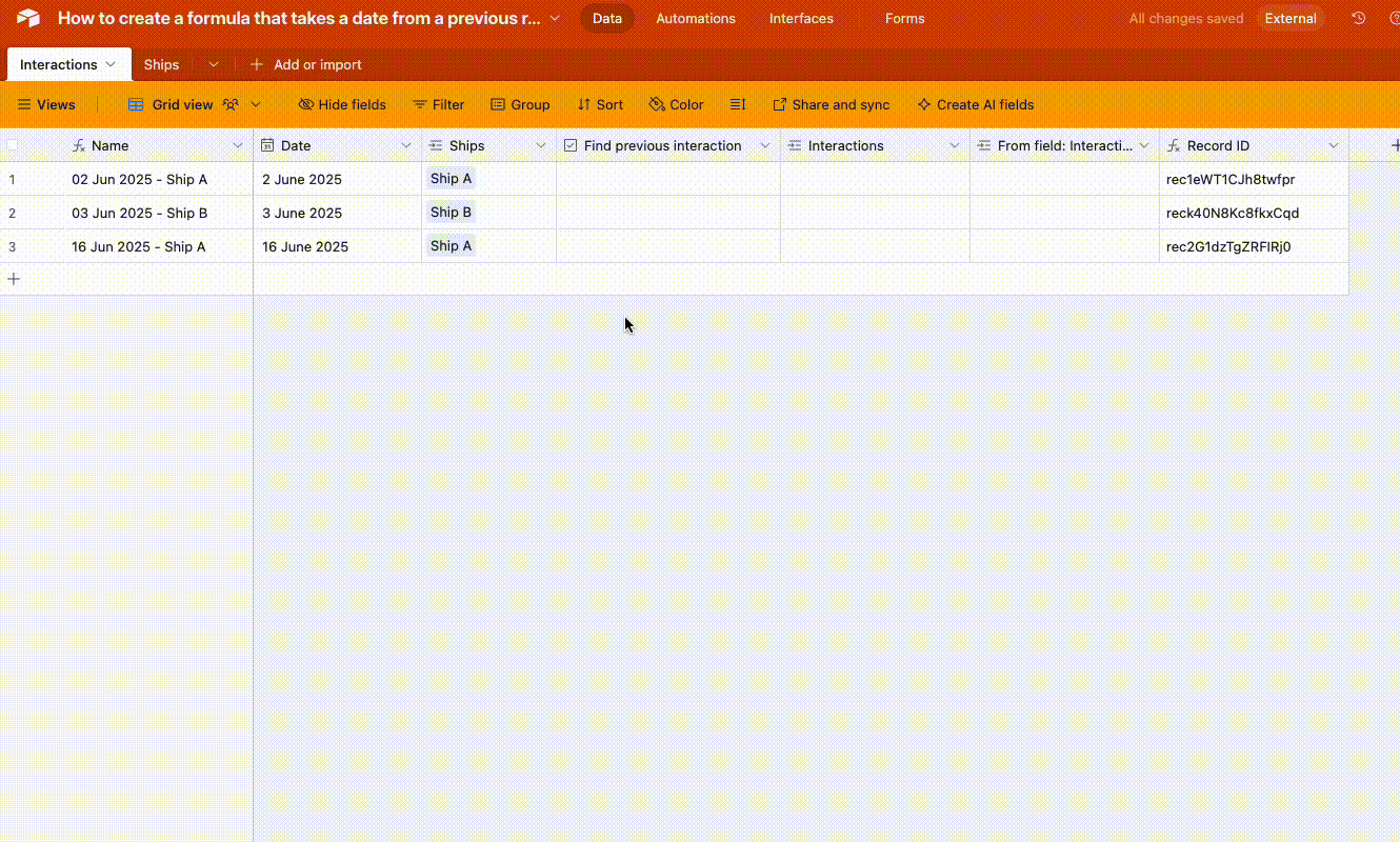

@TheTimeSavingCo  this looks like what I want but I have been trying for a couple of hours now to set it up in my own base but I don’t understand how the automation links to the field you have laid out? Sorry I do not use automation so I have no idea

@Taha-Jiruwala thanks I tried this but could not get past step 3 as there is no obvious way to manually link each record, I also have over 500 records to link so doing this manually is not an option
If you DM me an invite link to your base I’d be happy to help you take a look at it!
