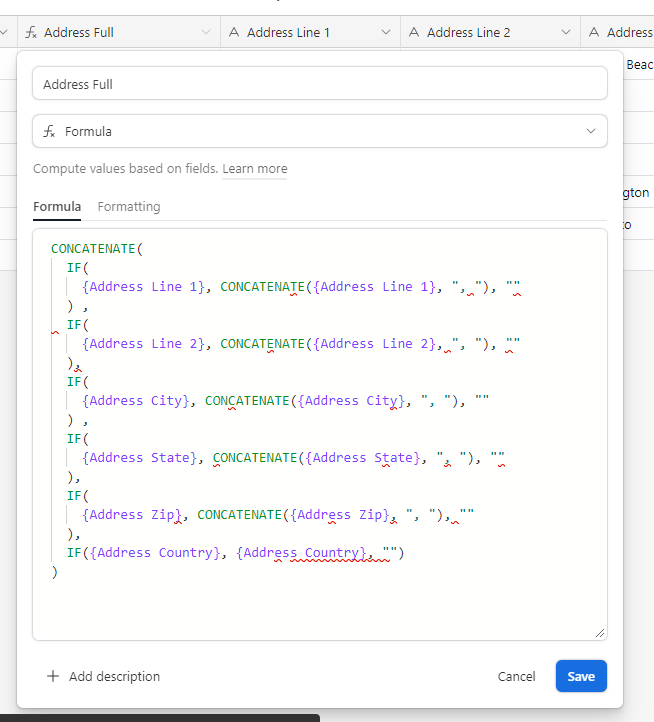

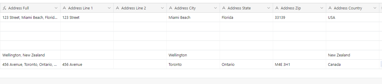

Hey @mc585 One way to solve this would be to break the address up into multiple components and then use a formula to 'build it back together'. Like when you purchase something online, there's usually 'address line 1' and 'city' and 'zip code' etc. Here's an example you can emulate.
Table Setup:
 Formula To Combine Address Fields:
CONCATENATE( IF( {Address Line 1}, CONCATENATE({Address Line 1}, ", "), "" ) , IF( {Address Line 2}, CONCATENATE({Address Line 2}, ", "), "" ), IF( {Address City}, CONCATENATE({Address City}, ", "), "" ) , IF( {Address State}, CONCATENATE({Address State}, ", "), "" ), IF( {Address Zip}, CONCATENATE({Address Zip}, ", "), "" ), IF({Address Country}, {Address Country}, "") )
Table Setup:
