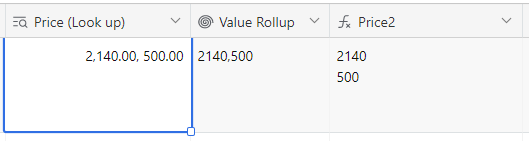

I'm having trouble formatting a lookup field in Airtable. Specifically, I have a "Price (Lookup)" field that I want to separate using line breaks instead of commas (in a new "Price 2" column), as I plan to use this column for a table in Page Designer. However, the currency format is being lost in the process.
Does anyone have any tips on how I can achieve this while maintaining the currency format?

Specifically, I have been trying to use a formula to create line breaks in my data, but instead of getting the desired format of
2,140.00
500.00
I got
2140
500
I was wondering if you might be able to offer any guidance or advice on how to address this issue.
Thank you very much for your time and assistance. I appreciate  it!!
Parn
The currency formatting is always lost when you convert a currency field to text in a formula field or a rollup field. If your formula or rollup returns a single number, you can apply currency formatting to the formula result. However, to have multiple numbers in one cell, then numbers must be converted to text.
This is just one of the quirks of Airtable.
One option is to convert the number to a text with formatting using a formula field in the original table. Then rollup the text version. However, the formula for making a "pretty" number can be complex. My extension Ready Made Formulas can create the formula for you if you have a premium license.
