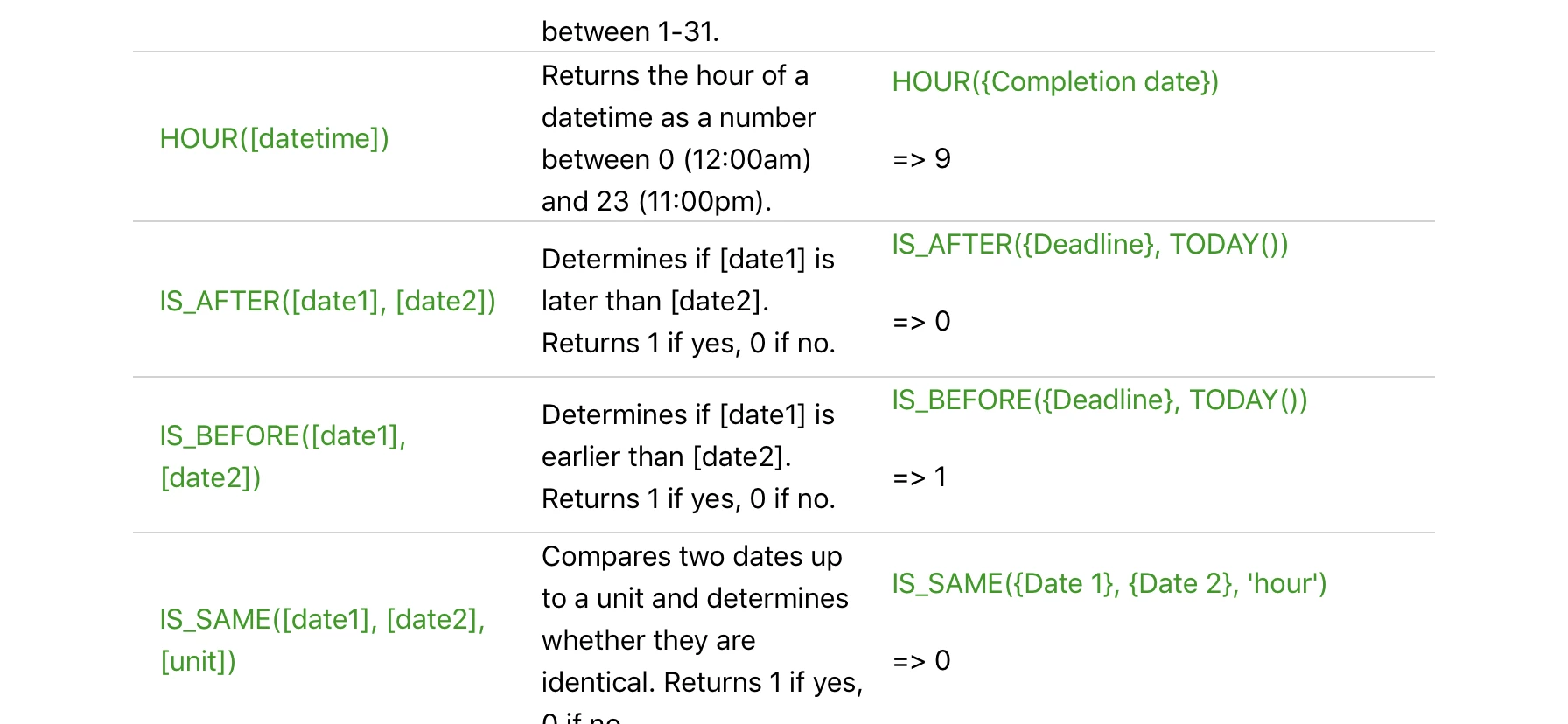

I assume the field called {Date} is actually a Date field, in which case your formula is trying to compare date data with a string using a mathematical operator. That’s not going to work because Airtable’s formulas don’t coerce data types for you to allow you to make comparisons in that way.
I’d suggest looking into these Date functions on the support pages

@Jeremy_Oglesby thank you. The following worked:
IF(AND(IS_AFTER(Date,‘12/31/18’),{Project Name}=“Sick Day”),{Total Hrs},0)
