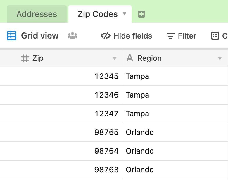

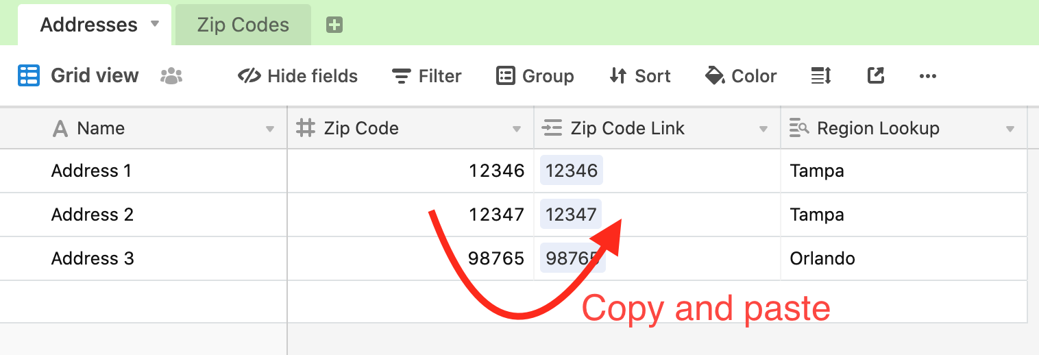

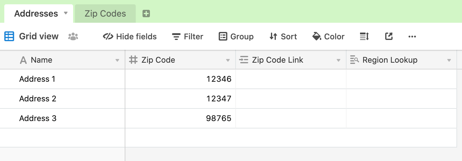

  • Have the zip codes and regions in another table and make a link field from your addresses table to this zip codes table. Then copy your address zip code into the zip codes link field and you can then lookup up the region/town in another field, like this:
(You can copy and paste multiple cells at a time).
