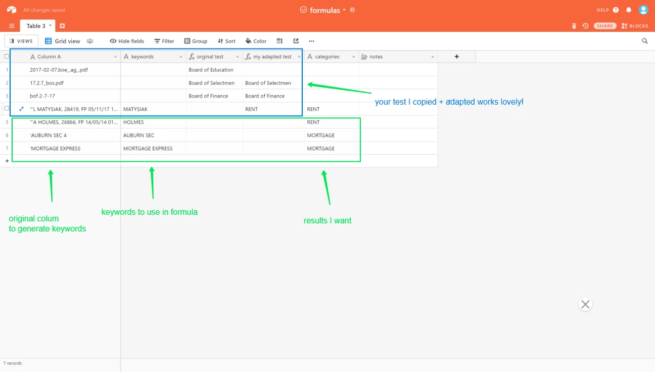

Hi JustinThanks for this have been looking for ages to do this but has taken me ages to work out what I was actually searching for!
So I have copied your formula and adapted but would love to know if I can take it further.
For example if I wanted “boe” “bos” and “bof” to return Board and then add other options say “one” “two” “three” to return Numbers. So I can have various text options giving selected returns without having to repeat the return each time. Hope I haven’t confused you can send a screenshot if it helps?
Thank you, Maria

I’ve got an idea of how this might work for your situation, but I’d prefer to see a screenshot to ensure that I’m going down the right path.

Wow! Thanks for such a speedy reply.
My objective is: to pull regular keywords from a bank statement where the rest of text can vary to be able to automatically categories transactions using the formula field.

Yes, that makes sense, and assembling the formula should be fairly easy. In short, I suggest using a series of concatenated IF() functions, each one isolated on finding keywords for a specific category. Here’s where to start using the examples you provided.
    OR(
        FIND("MATYSIAK", {Column A}),
        FIND("HOLMES", {Column A})
    "RENT"
    OR(
        FIND("AUBURN SEC", {Column A}),
        FIND("MORTGAGE EXPRESS", {Column A})
    "MORTGAGE"
Provided that your keywords are specific and unique, only one IF() function will return a non-empty string, with the rest returning empty strings. Concatenating one or more empty strings onto a non-empty string won’t add any extra characters, so the final result will be a single clean string.
FWIW, I used FIND() instead of SEARCH() like the original had, but it doesn’t matter which one you use. You could replace each “FIND” with “SEARCH” and still get the same end result.
