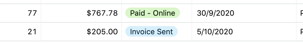

  • October 9, 2020
Thank you!
So it worked but it also did everything before 01/10/2020
The first column is the 10% formula
  • October 9, 2020
I noticed that you have your dates formatted as Day/Month/Year.
However, since you do not specify the date format, Airtable probably thinks that you want dates after January 10, 2020, not dates after 1 October 2020.
You can tell Airtable the format of your date by using DATETIME_PARSE
IS_AFTER({Date Purchased}, DATETIME_PARSE('01/10/2020', 'DD/MM/YYYY'))
