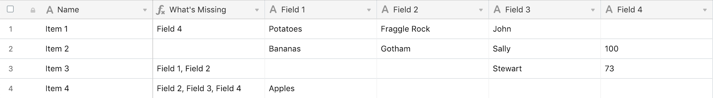

I thought a visual aid would do a better job than me describing the goal. Below is an example image of what the finished product would be. I am trying to create the “What’s Missing” field. Whenever the other fields are not filled out, they are listed in the “What’s Missing” field.
In that case, you want chained IF() statements rather than nested.
