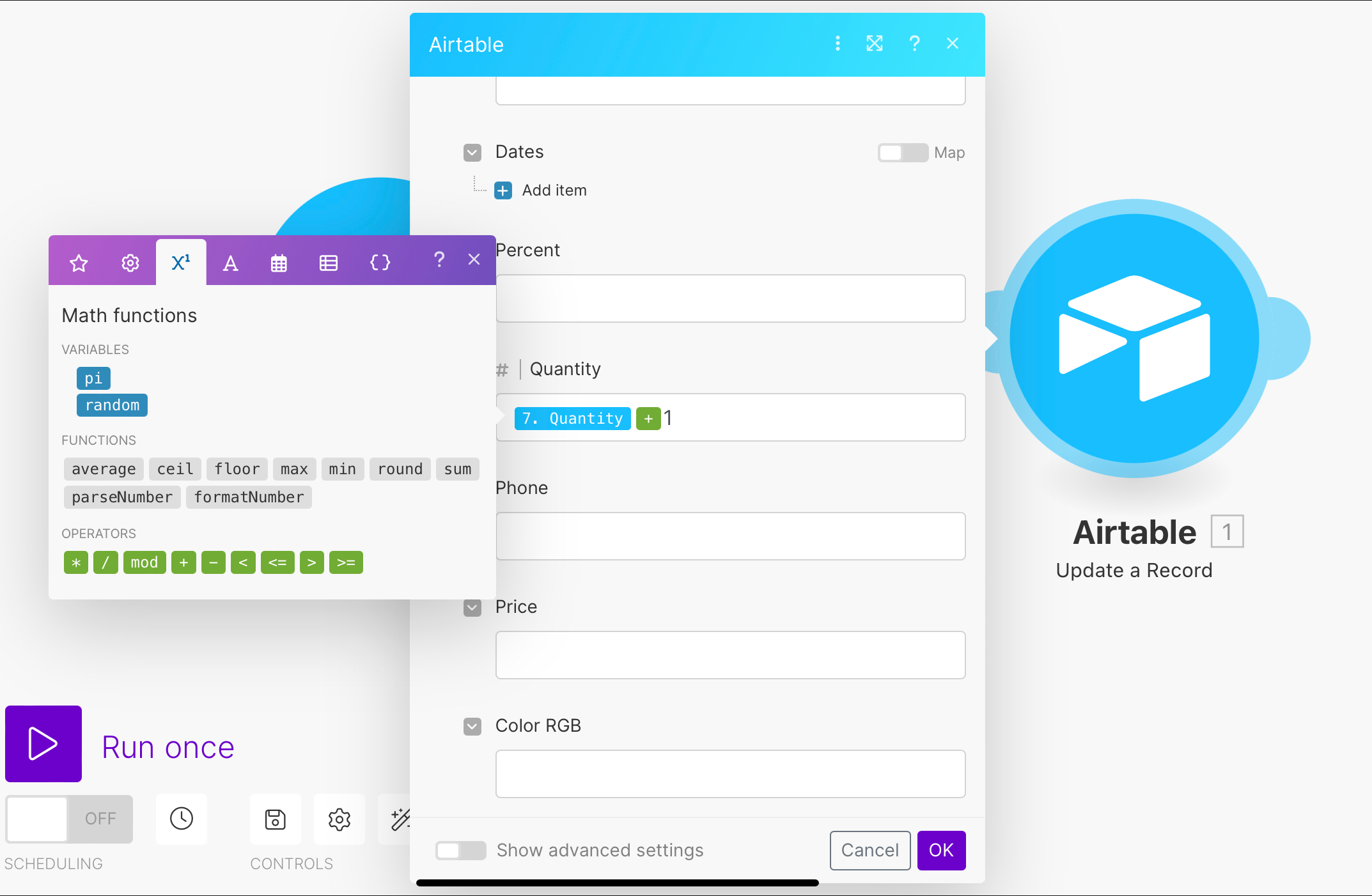

Best answer by ScottWorld
Follow my screenshot. Start with the field name in that box from a previous module.
It will end up looking like:
Compteur SMS + 1
Sure, Make has math functions built into their app.
In your case, just use the plus sign on the math panel to increment the number by 1.
Don’t type the plus sign because that won’t work… you will need to choose Make’s plus sign.
Check out the screenshot below:

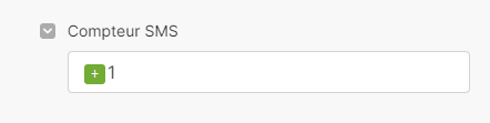

Thanks for this idea!
The problem is : the initial quantity is 0, I can't leave the box empty and just write "+ 1".
Have you an idea ?
Compteur SMS + 1

It works, thanks a lot !
Awesome! You're welcome! 🙂
