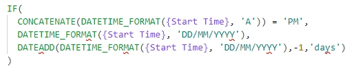

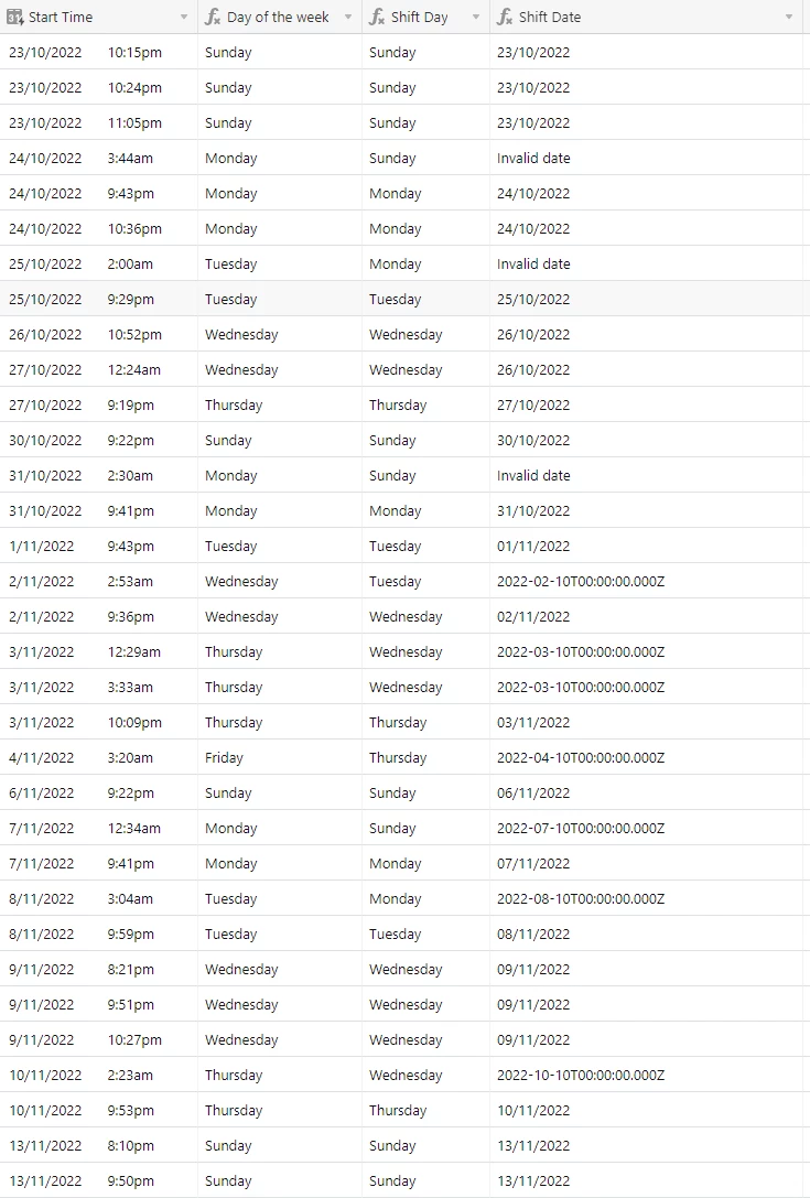

I am trying to make a formula that takes the date/time from a previous column, and if the time is in the p.m, display the current date, however, if the time is in the a.m, to display the previous day's date. Attached it my current formula, which works for the p.m. times, but shows a mixture of 'Invalid Date' and an oddly specific time (see photos)
Any ideas what I'm doing wrong?

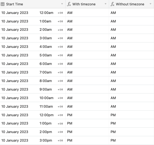

Ouch yeah, you're right kuovonne.  I put something together so that I could visualize it better:
The field "With timezone" has the formula
DATETIME_FORMAT( SET_TIMEZONE( {Start Time}, 'Asia/Singapore' ), 'A' )
And the formula for "Without timezone" is
DATETIME_FORMAT({Start Time}, 'A')

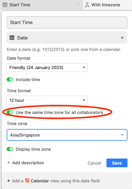

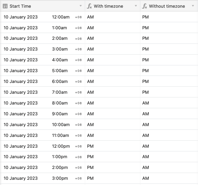

I was thinking that as a potential solution perhaps we could use the "Use the same time zone" setting?
Once we start using that setting the times seem to output the way we would want it to I think
