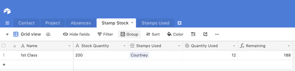

This is actually very simple to do in a database - first you have a Stamp Stock Table like this:

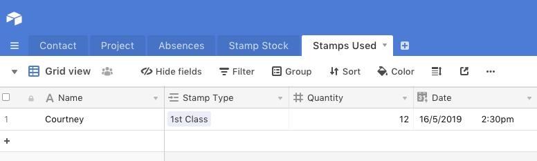

and a Stamps Used table:

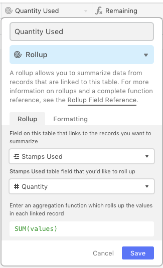

The clever bits are the 2 calculated fields on the Stamp Stock table - the first Quantity Used is a Rollup field from the connected Stamps Used Table:

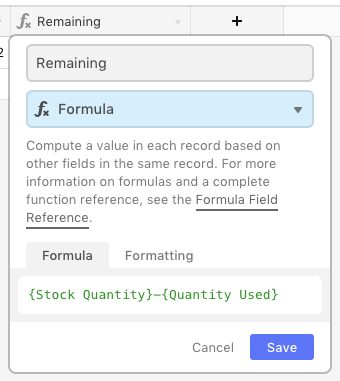

and the second, Remaining, is a simple formula:
