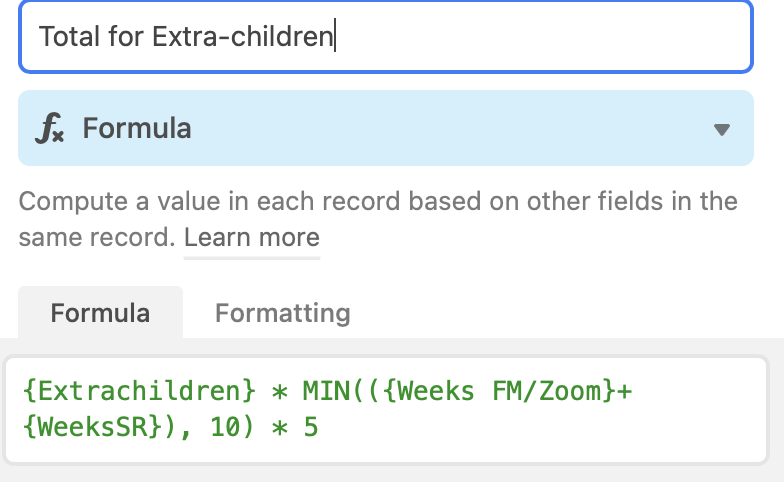

Is this a case for an IF statement?
My database has run well for 3 months but now I need to change the discount structure. I have added a Column and called it Qtr and each record will be either 1,2,3,or 4 the idea being that the discount offered for that Qtr could be different.
So far I have two different discount formula but how do I add the qtr to the formula
![Screenshot 2021-03-06 at 15.11.14|700x210]
Formula

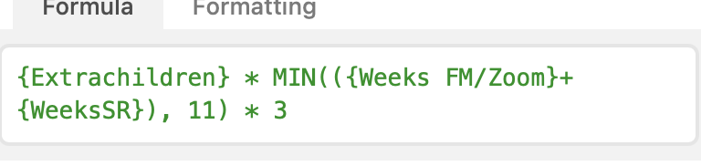

![Screenshot 2021-03-06 at 15.12.22|700x165]
or

Since you’ll be comparing the same value to four known values, this seems like you want to use a SWITCH() uses.
SWITCH(
   {Qtr},
   '1', {Extrachildren} * MIN(({Weeks FM/Zoom} + {WrrksSR}), 10) * 5,
   '2', {Extrachildren} * MIN(({Weeks FM/Zoom} + {WrrksSR}), 10) * 3,
   '3', ...,
   '4', ...

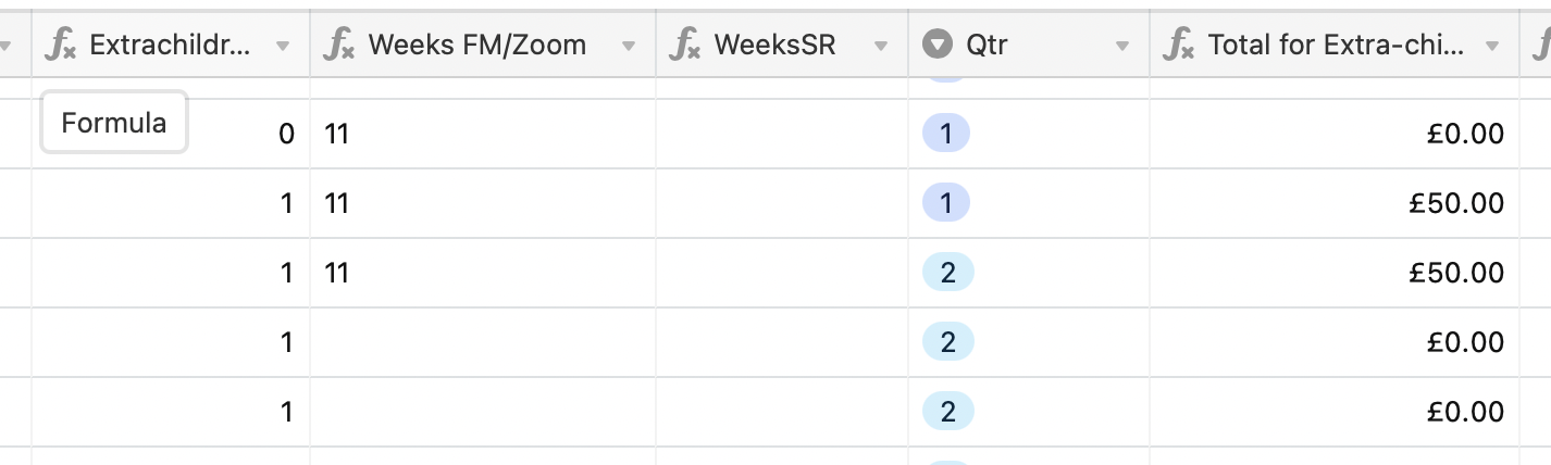

Here is a copy of part of the live database as of this morning.
(you are welcome to have full access to it if it helps)
Any guidance would be greatly appreciated as I have no idea what I am doing wrong.
Many thanks in advance for your reply.

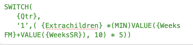

Looking at the alignment of the data in your columns, it looks like {Weeks FM} does not report as a number (noticed how it aligns to the left link string, not to the right like a number).
I believe you’re getting errors because you are trying to perform math on something that is technically not a “number”. Try VALUE({Weeks FM}) + VALUE({WeeksSR})
You are correct as the Weeks FM has a formula to take numbers from a text field.(for a reason that I can’t even remember, but it has been working.)
I have assumed your instructions of adding the word VALUE was to the Syntax that you sent me, so I tried it but it didn’t save.
It is likely that I have a bracket in the wrong place but I regret to being too old to stay up through the night trying different combinations.
I will try in the morning but if you see anything obvious that I have done wrong I would appreciate your guidance.
Thank you once again for your input.
Phil

Your MIN() function is missing the beginning parenthesis., and you have a random comma after the 5.

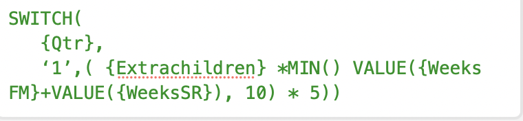

Thanks so much for your continued help and I am sorry for my ignorance.
Comma has gone.
I have put the ( in front of MIN and tried it without the ) and then putting the ) in every position I can think of but it is still not saving.
Do you have any other ideas I could try?
Many Many thanks for all your help.
Phil

In that screenshot, you still are missing the opening parenthesis for MIN(). You wrote the word MIN and then added a space and then started another function.

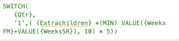

Will I ever get this correct?
As you can see I have tried a number of minor changes but all are wrong and will not save.
I keep reading your note but I am afraid it is not clear to me as clearly I am not understanding something that I guess is obvious to you.
Would you mind typing the complete change I should make.
Once again thank you for helping me.
Phil

After getting the Qtr 1 to work I had two closing parenthesis.
Onto Qtr2.
Looking at your previous examples it appeared I needed to do away with those closing parenthesis and put in a coma as the formula was to move onto the Qtr 2. I have now tried adding a parenthesis before Extrachildren (as instructed) so my logic says that I need to add 3 closing parenthesis (2 from the 1st qtr and one from the one I added before Extrachildren. Clearly I am wrong as it doesn’t save.
But why?
And why does the parenthesis become before Extrachildren and not before ‘2’
Kamille_Parks11
Forum|alt.badge.img+27
I do really appreciate how you are trying to teach me. I am just aware how much of your time I am taking when it is unlikely at 73 I will ever do another database, I certainly will not say I can help my niece again!!! Thats not strictly true but I am getting frustrated.
Onto Qtr2.
But why?

So, walking through your use case, here’s the structure:
SWITCH(
   {Qtr},
   "1", (insert x1),
   "2", (insert x2)
x1 == {Extrachildren} * MIN(({Weeks FM} + {WeeksSR}), 10) * 5
x2 == {Extrachildren} * MIN(({Weeks FM} + {WeeksSR}), 11) * 3
Again, you don’t have to wrap “x1” or “x2” within parenthesis, but if you did want to, your formula should be:

I know I had to be spoon fed but I can’t tell you how much I appreciate the time and effort you have put in with me.
Naturally your last answer has saved correctly and even calculated correctly.
You will not be surprised but I am certainly relieved.
I will read your last comments again tomorrow and try to follow the logic and fully understand what you wrote but for now I want a glass of wine and to close my eyes.
Thank you and good night. I might even be able to sleep tonight knowing the problem is solved(well at least on the test system).
