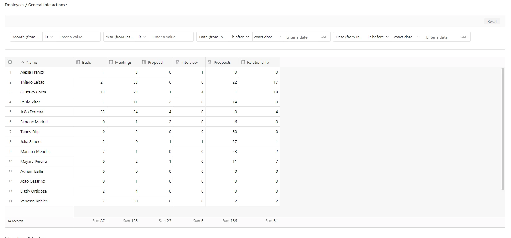

I'm facing a problem when trying to filter the date in the interface. Whenever I select the month it shows me the total, the same happens when I use the specific date filter. Do you know any formula or trick to solve this problem?

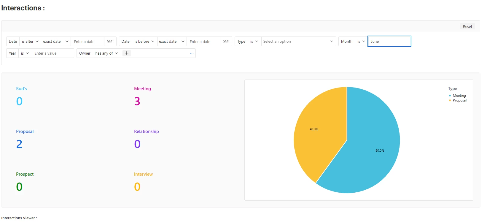

Sorry for the lack of information, I'm trying to make an interface page with two tables, Interactions and employees, my client needs to have all employees filtered in this Employees table interface by data, I'm getting the result I need with counting numbers and graphs in the interactions table , this is the result I need to show in Employees Interface table:

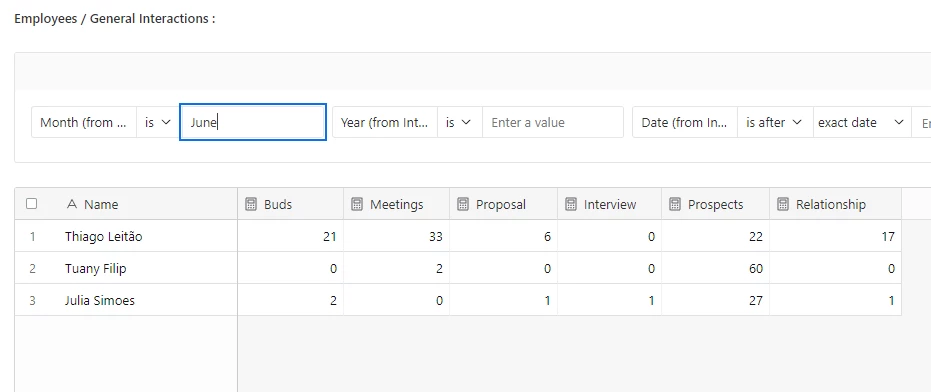

I'm not sure if this is possible in the employees table, my question is if it is possible to make a formula to have the same result as above.

If I can make a suggestion, I would use the employees table as the core as it seems all the other tables all point to employees. Then have linked records with lookup or rollup fields that are important pieces of information pertaining to each employee. So in essence, the answer to your last question is yes it's "possible to make a formula to have the same result as above." I would create a lookup field in the employees table (from Interactions) with month and then in the interface your filter will work. Then on the filter in the interface you can say 'When month > Contains > July 2023.

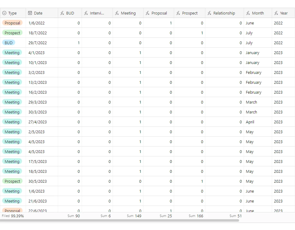

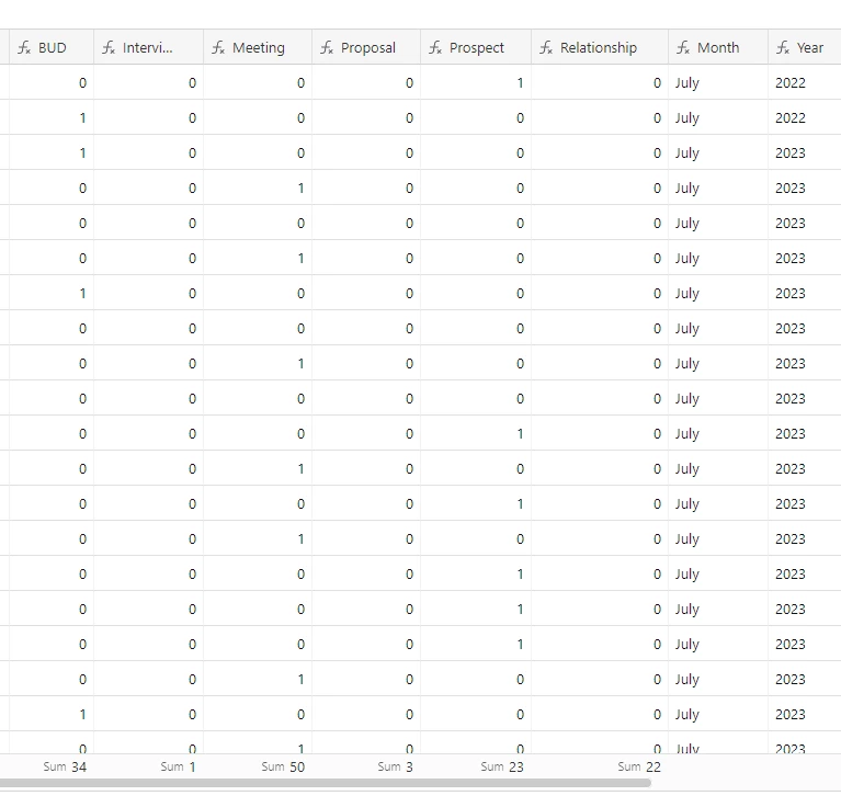

I ended up taking a different path and was able to achieve the desired result. Using the 'employees' data didn't give me the numbers I needed, so I looked at the 'interactions' data instead. I applied an IF(FIND("BUD", Type) > 0, 1, 0) formula and for others {types}. At the bottom of the table, the client can see the sum. It was the only way I could manage to do it. If you have any advice, please feel free to share.
No filter:
Filter applied for July:
