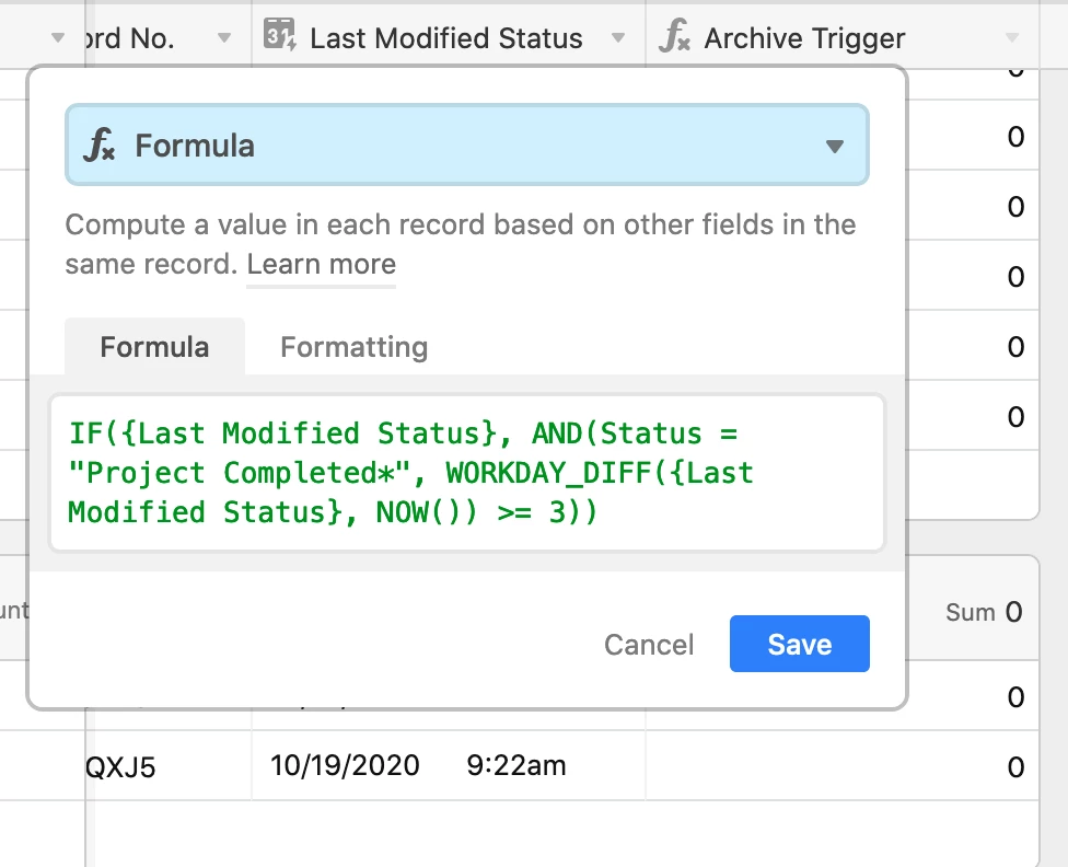

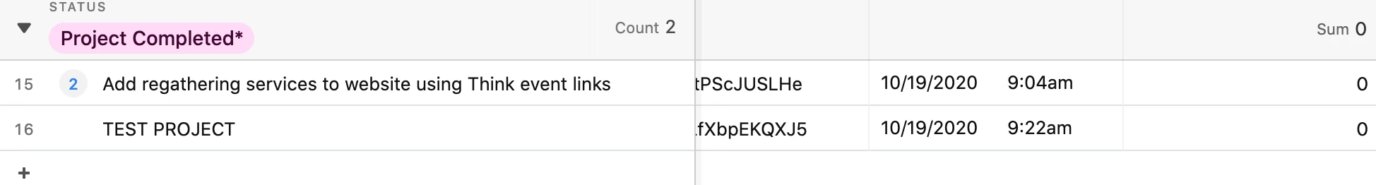

Hi Justin!
I followed your instructions but I am not getting a 1 when the status is Project Completed*. Any ideas?
Thanks,
Lisa

Remember the dual-condition of that formula. The only fields I see in your screenshots have today’s date. The formula will only output a 1 when both conditions are met, and one of the conditions is that the {Last Modified Status} date is more than 3 working days ago, which isn’t the case in those examples.

Justin:
I misread your first email and thought the formula outputted a 1 when the status appears as “Project Completed*”, then after 3 workdays it would change the status to archive. I understand now.
Thanks for your help!
