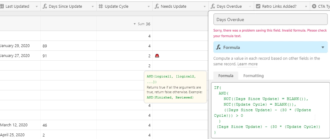

Thanks for this kuovonne, however, I am getting an error message when I insert that code. Is it correct?
  • April 27, 2020
Sorry, there was a missing comma.

  AND(
    NOT({Days Since Update} = BLANK()),
    NOT({Update Cycle} = BLANK()),
    ({Days Since Update} - (30 * {Update Cycle})) > 0
