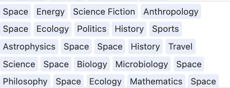

Hello-
I have a lookup cell that is pulling data from multiple cells. The results are showing a list of topics. The topics are repeated (as they're pulling from different cells). You can see, for example, that "Space" is being pulled multiple times. Is there a way to tell it to only list topics that haven't been listed, meaning only unique topics (not duplicates)?  Thanks in advance!!

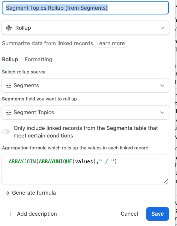

Use a rollup field instead of a lookup field. Use the rollup formula ARRAYUNIQUE(values). I like to nest it inside ARRAYJOIN(ARRAYUNIQUE(values), ", ").
You will loose the pill appearance and the click-through ability.

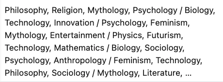

Thanks.  Did that (I used / instead of "), but it's still showing duplicates from the multiple cells it's pulling from...
Looks like you have a nesting situation where you are looking up things from two tables away. You need to create a lookup in the middle table (even if it is a lookup of the primary field value shown in the linked record field). Then have a rollup of the lookup field and flatten it.
ARRAYJOIN(ARRAYUNIQUE(ARRAYFLATTEN(values)), " / ")

Hi all-- thanks so much for the replies. I actually just added a new AI field and told it to pull from that field, separate them by " / " and then alphabetize. It worked perfectly!
