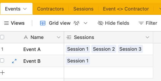

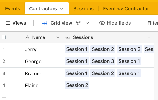

I have a table of "events", and table of "sessions" (an event might be made up of 1 or more sessions/ days) and a table of "contractors". I assign contractors to "sessions" through linked records. A contractor may work 1, 2, or all "sessions" of an "event". The sessions have a set number of hours assigned to each, and I've got a payment formula.

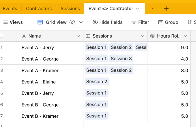

The idea is to create one new record link between an Event and a Contractor, resulting in that "Event <> Contractor" table.  From there you'll be able to make rollups to get the total number of hours and calculate the pay

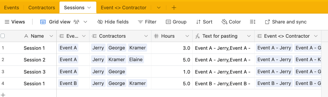

To make sure the "Event <> Contractor" table is always updated, I made a formula field that'll basically create the record titles for us, that's the 'Text for pasting' field, and you can see it outputs "Event A - Jerry,Event A - George,Event A - Kramer"
I then have an automation that'll trigger when that field gets updated, and its action is to paste the value from that formula field into the linked field to "Event <> Contractor", which creates the records for us
