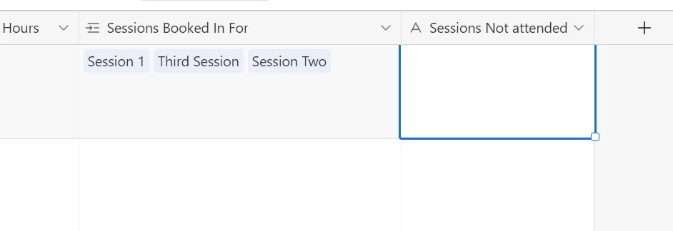

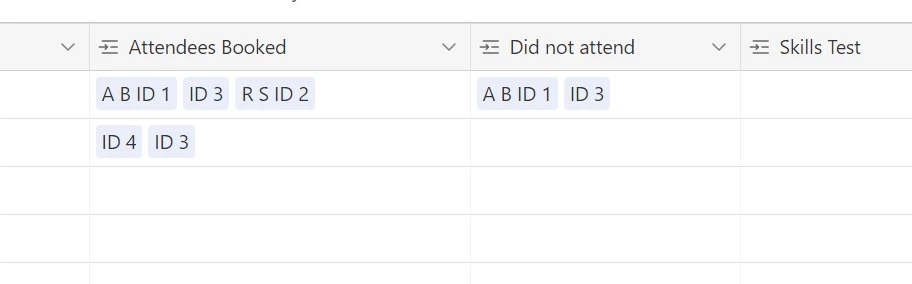

Hi, I'm pretty new to Airtable and currently just exploring if it will be viable for our company to use.
The set up I have is two tables, one for learners and one for workshop sessions.
The sessions table has names etc and a field linked to the learners table that shows the attendees booked on the session (multiple select allowed).
The learners table has a similar field linked to the sessions table showing the sessions that they are booked on to (again multiple selections allowed).
What I would like to be able to do is have a new field on the sessions table that for example shows the attendees that did not show up (nothing fancy I would just use a linked field to the learners table and just input the learners manually, again multiple select allowed). But then I want a corresponding field on the learners table showing the names of sessions they have not attended, is there a way to populate this with the session name (stored on the sessions table) based on the did not attend field on the sessions table? I felt like I was a good way towards this using a rollup and IF function but then could not pull the session name through as it was not a recognised field (because it is stored in another table), plus I don't know if it would pull multiple entries through in any case.

Thanks for the speedy reply, I'm assuming there just isn't a way to do this without generating a unique record for each workshop slot? I think ultimately the extra records this will generate will make it untenable for us in the long run but thanks for explaining it.

I've just rechecked the tables you've suggested in your jpeg and its definitely not the way to go. You'll end up with a table for both Bookings and Non Attendees. You just want 1 table (the attendances table) where you log bookings and if they turned up or not. If you already have a Bookings table this is all you need - consider it Workshops, Learners and Bookings tables. Then you can run the summary you want in the workshop table using a lookup.
