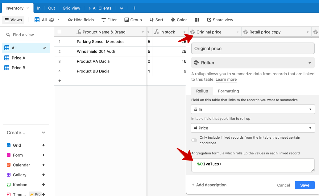

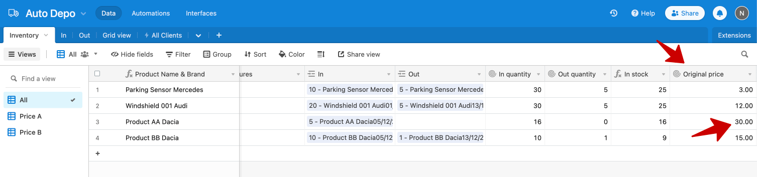

I created an inventory for an auto shop.
How to show the last price added for the product?

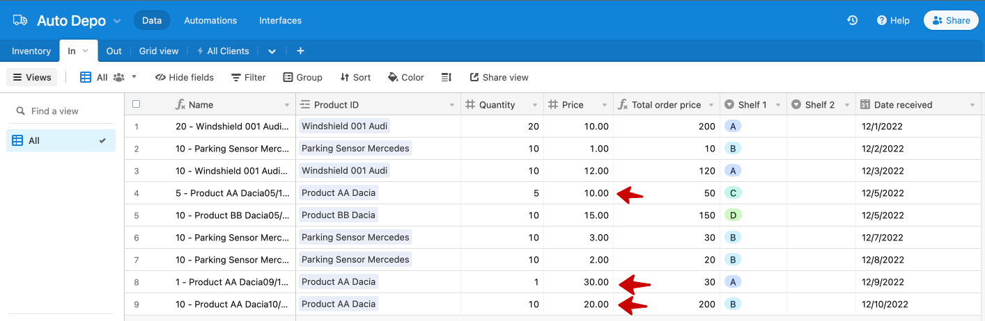

Example:
Product AA - we bought for $10
Latter with $30
And after a couple of weeks price decreased to $20
Now I can make only average or max.
Here is a screenshot how I made MAX value added for this product.
I found a formula like LAST_MODIFIED_TIME()
But I don't know how to use, to display last price of product added
Thank you

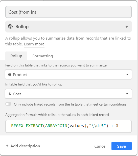

Collect all the prices into a string, then extract the latest element (price), and finally convert the result into number.
I think I've found a better Regex expression to handle this, that will work with decimals too;
REGEX_EXTRACT(ARRAYJOIN(values), "[^,]*$") + 0

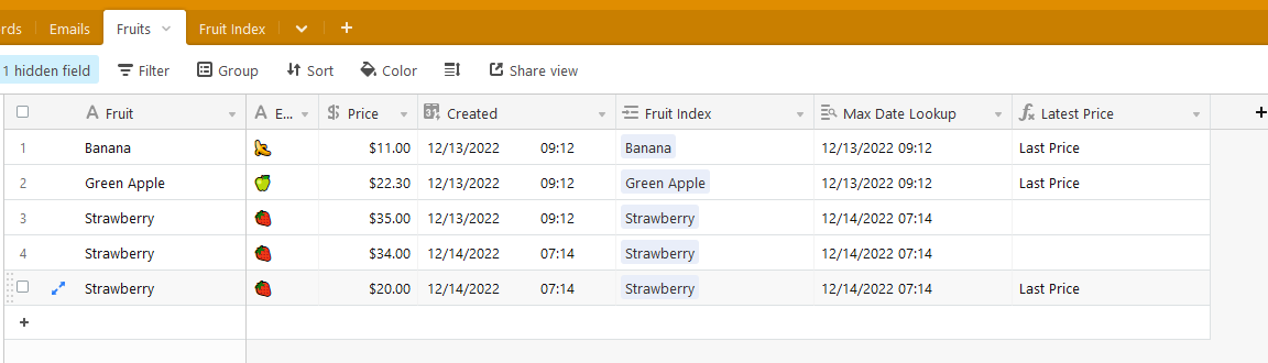

@ScottWorldsolves this problem well with the method he discusses in this thread;
https://community.airtable.com/t5/other-questions/select-the-top-record-on-a-specific-view/m-p/64845#M16242

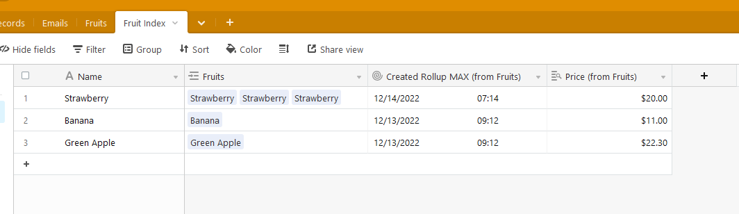

Out of interest, I just tested it out myself as I can see if being overly useful, and it works well!
Here we have a list of records, each with unique prices - and importantly they're tied to a product index. Note the "Latest Price" formula field - this is key for this to work.
And the resulting Product Index table, with the correctly detailed last price entry lookup;

Hello @CreateGo ,
I can suggest the following formula for the rollup field:

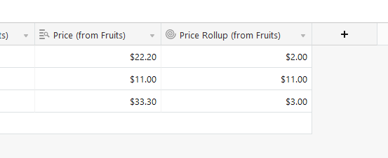

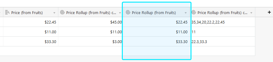

Love this! But that formula may need need tweaking as it does fail with certain values;
Karlstens
Forum|alt.badge.img+24
  • December 13, 2022
Hello @CreateGo ,

Karlstens
  • December 14, 2022
Wow, thank you, guys!
@Andrey_Kovalev @Karlstens
Works amazing! You are amazing 🙂

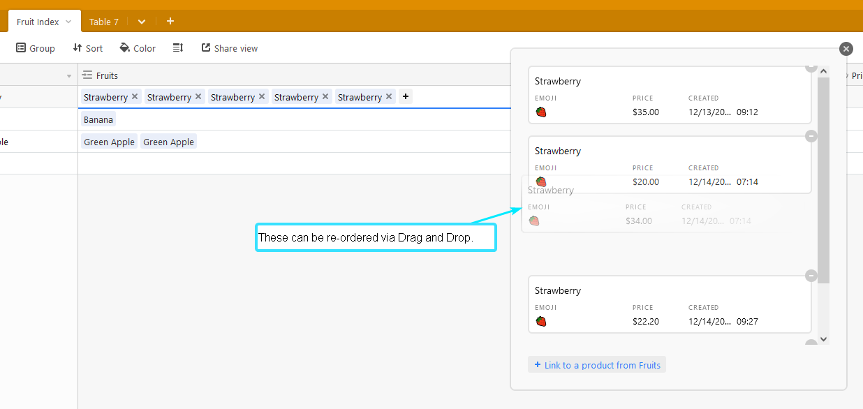

Just keep in mind the main difference between these two techinques - the first that I copied from ScottWorld's post is more robust and should always return the value you're expecting. However the Regex solution has two risks to be wary of - the first being the regex code itself, in that it looks to be working but make sure you test thoroughly. But more importantly, be aware that the regex is simply matching the last element of a mimic'd array, an array that can actually be re-ordered through Airtable UI that will cause it to stop reporting the correct value.
Frustratingly, there's no "Keep Sorted" toggle on a Linked Record field (and I feel that there should be a sort option, or have the ability to order as per an associated View - but alas I'm still waiting for this feature).
If you're working with the regex solution, you may want to protect the Linked Record field from being manually manipulated, or write an automation that keeps it in the correct order.
