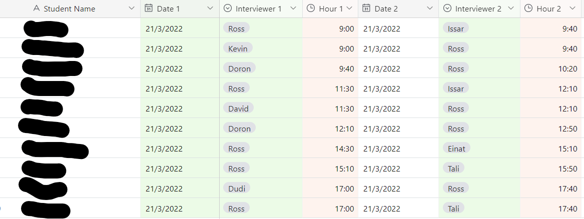

We interview students and each student goes through 2 interviews by 2 different interviewers. Each interviewer has their own column with their interview time. See an example.

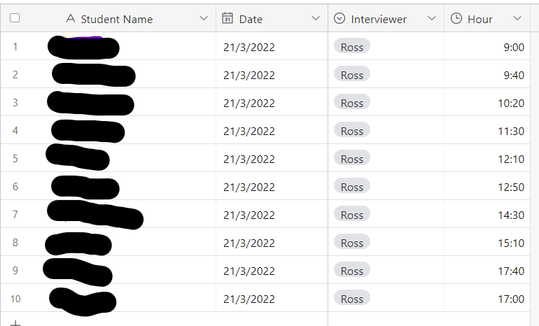

If we take the interviewer Ross as an example, how can I get to the point where I have only one column of the interviewer's name and his interview hours? I want to get to this view-

The first screenshot is a shot of the base itself. You are right, I eventually want to reach a situation where I have one column with the name of the interviewer and another column with the hours. (As you wrote: to have a single record that represents "Ross" with all of their hours added together). Like the second screenshot I created for the example.
Just need to take into account that besides "Ross"  there are 80 other interviewers, and if I want to have a single record  for each one of them with all of their hours added together, and I will use a formula, does that mean I have to use it 80 times?

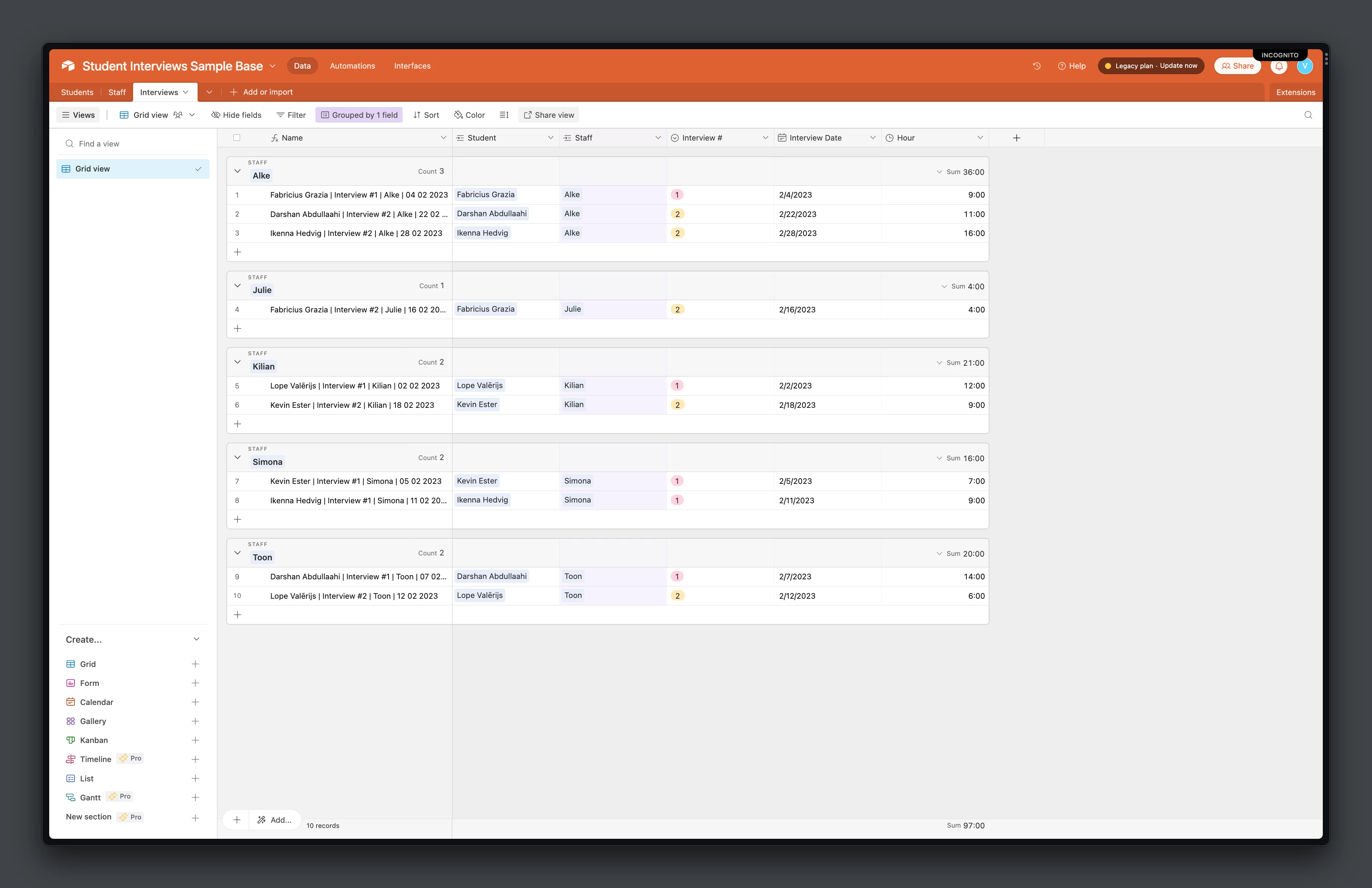

Hey Rachel,
Looking at your structure, I'd suggest you make a few changes.  See the below base
As you can see on the Interviews table, we can now use groups to get the required result.
I'm sure there are other ways to achieve the same thing but to me, this is the simplest method I can think of doing this without having to resort to a lot of formula's and complex table structures.
I hope this helps!
All the very best
Vatan
