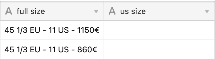

hi dear community,
i need help finding the correct formula, but at least i know that the mid and find function have to be included.
i want to extract the text between both “-”, so for example “11 US” is visible in the “us size field”.
any help is greatly appreciated, if there are any questions regarding my concern, please let me know.
kind regards karim and thanks in advance! :slightly_smiling_face:

hi chris, first of all thanks for your reply and your time. unfortunately none of the functions is working due to an error in the function. at first i copied your formula and then i tried to replace the “txt” with the fields name I’m referring to, but both options didn’t work out for me :frowning:

Hi Karim. Sorry they didn’t work for you. Here’s a little shot that shows them both working. Did you copy/paste these from above or did you type them in? Make sure the quotes are not curly double quotes.

hi guys, first of all huge thanks to @Chris-T @ScottWorld !
it was like Scott said, the problem were the straight quotation marks and the “txt” didnt work out for me as well.
i ended up using the following function, which works now after keeping your tips in mind.
REGEX_EXTRACT({full size},"-+(.*?)±")
again thank you guys and stay safe! :slightly_smiling_face:
