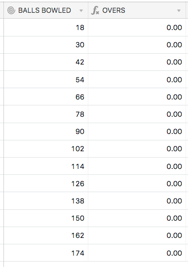

I am trying to understand a why a simple MOD function isn’t returning the correct answer.
Airtable: Organize anything you can imagine
Airtable works like a spreadsheet but gives you the power of a database to organize anything. Sign up for free.
( I can grant you access so you can see the formulas)
On the table titled “SEASON STATS OVERVIEW”, in the OVER field, I am trying to build a larger formula and part of it requires me to use the MOD function. The formula in the OVERS field is MOD({BALLS BOWLED},6) but for some reason the record for player 2 is returning a value of 6 when it should be 0. I have tested the MOD function for the number 30 as a number i.e. not generated from a roll up function and that works. But for some reason when the number 30 is generated from a Roll up formula is returns an incorrect value.
I can grant creator access to you if you need to see the formula fields/
Any ideas/assistance, all gratefully received.
Thanks in advance

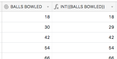

After messing with it a bit, I don’t think it’s a problem with MOD, but rather a side-product of some of the math taking place leading up to that, and how those values are being represented internally, regardless of how they appear based on the field formatting options.
First off, using SUM(values) as your aggregation function should return a number, so forget what I said above about the array-to-string-to-number conversion process. That’s not necessary.
Here’s one of the primary clues that leads me to think that the internal numbers are not as clean as they appear. I made a test formula to force {BALLS BOWLED} to an integer:
INT({BALLS BOWLED})
Putting that next to {BALLS BOWLED}, the result for that problem line surprised me:
Because the INT() function “Returns the greatest integer that is less than or equal to the specified value.”, that tells me that the true value of {BALLS BOWLED} isn’t an even 30 like the field displays, but actually 29.??? However, I wasn’t able to see that detail by forcing {BALLS BOWLED} to display as a decimal, even with the highest precision formatting option.

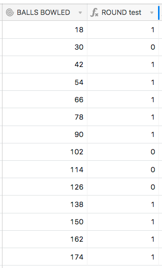

My next test was to try to round the value with the ROUND() function, and see how the rounded value compared to the unrounded one:
ROUND({BALLS BOWLED}, 0) = {BALLS BOWLED}
Based on the earlier INT() test, the results didn’t totally surprise me, but also showed that other values were also not as clean as they appeared on the surface:
In the end, applying ROUND() in your {OVERS} field did the trick:
MOD(ROUND({BALLS BOWLED}, 0), 6)
Why isn’t the value cleaner even though you’re using a combination of rounding functions leading up to that? No idea.
INT({BALLS BOWLED})

It looks like you will need to round your original value of “Balls Bowled”, because if you look at the new formula that I just created, which is: {BALLS BOWLED} & "", it results in non-integer values.
So this formula will work for you:
MOD(ROUND({BALLS BOWLED},0),6)

@Justin_Barrett, it looks like the formula worked without needing to go through your workaround of converting the rollup field into a string, and then a value. Does this mean that Airtable now works properly when applying the “MOD” function to rollup fields?
I don’t think it’s a case of it working properly “now” vs some other behavior in the past. My impression is that the output of a Rollup field depends on the aggregation formula used. It wouldn’t make sense for SUM(values) to return an array. Same thing for MIN(values) and MAX(values). However, some aggregation functions will still create arrays. In short, it’s a case-by-case situation.
