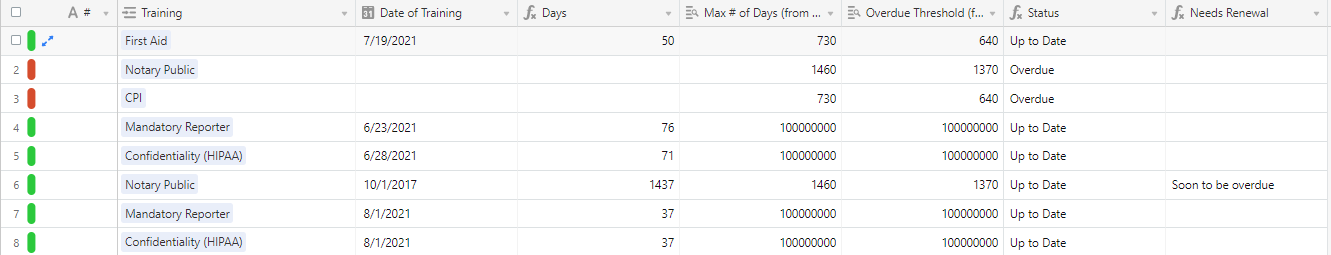

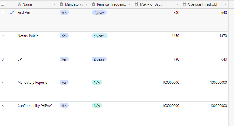

Hi thanks for responding and my apologies for the delay in response. I was on vacation. Unfortunately that doesn’t work with my use case. I’m attaching images to show what those columns actually look like.
The first image shows the training name, and the columns Max # of Days and Overdue Threshold.
The second image shows the two equations that I mentioned in my initial post at work. Status is the first function listed and Needs Renewal is the second. I’m trying to combine the syntax of the the two so that it’s only one column.
Hopefully this makes more sense. Thanks again for the help. I’ll play more around with reworking the SWITCH function idea when I get back into the office tomorrow.
