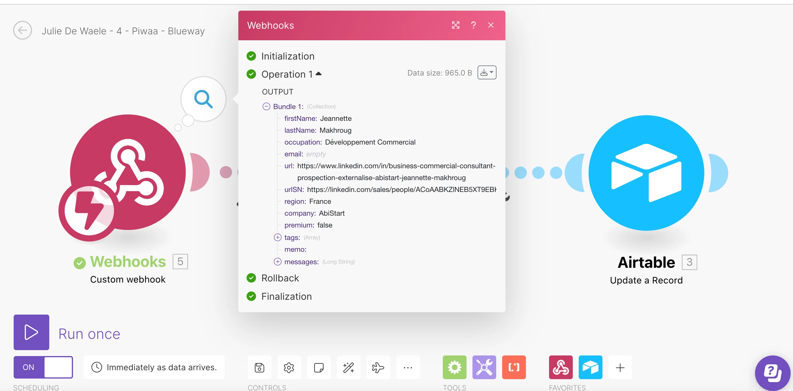

I have a scenario one Make, sending infos from piwaa (linkedin connected inbox) to my airtable

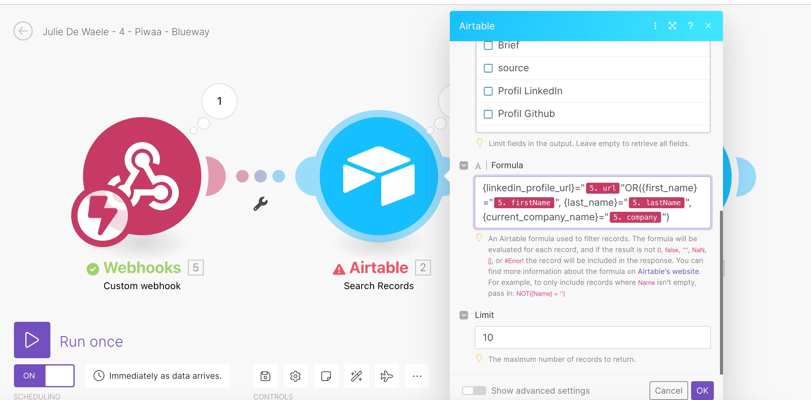

For the module Airtable search records, I have a formula to help finding the record concerned
I want it to find the right record to update thanks to my formula, -> linkedin url, OR if it’s not possible, firstname + lastname + company name
My formula is not working and I can’t figure out why…
Thanks a lot in advance for your help
Kenneth_Raghuna
Forum|alt.badge.img+20
Is the formula shown the full formula you have in that box?
If so it is not a valid Airtable formula. You probably want something closer to this:
IF({linkedin_profile_url}='5.url', 1, IF( AND({first_name}='5.firstName', {last_name}='5.lastName', {current_company_name}='5.company'), 1, 0) )
