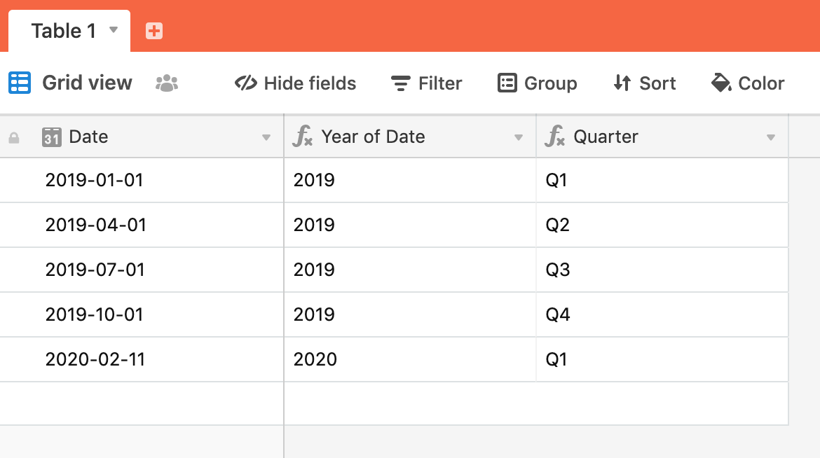

Hi @KVC - try this:
The Quarter formula is:
  AND(Date >= DATETIME_PARSE({Year of Date} & '-01-01', 'YYYY-MM-DD'), DATE <= DATETIME_PARSE({Year of Date} & '-03-31', 'YYYY-MM-DD')),

I’ve created a helper field “year of date” which you can hide if you don’t want to see. The formula above is based on the “normal” calendar quarters so just modify to match your custom quarters.

…or replace {Year of Date} with YEAR(Date) and the extra field isn’t necessary.
