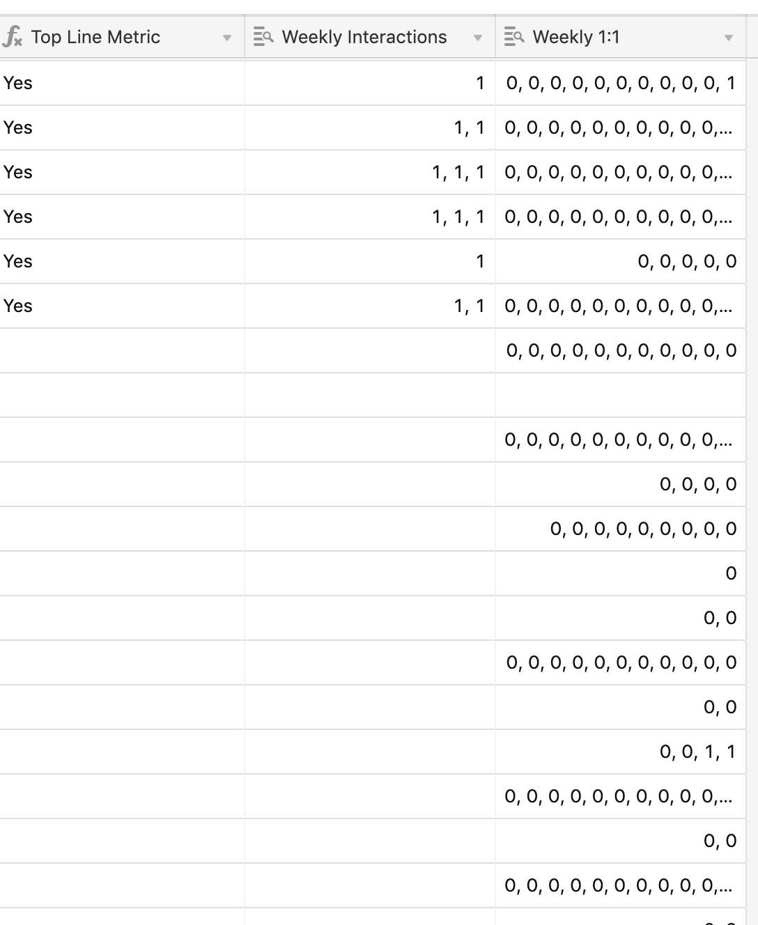

One more question if I may! I got it all in place and it seems to be working except for I have 1 teen who has an interaction in “weekly 1:1” but not in “weekly interaction” so it’s not returning the yes like I want it to… what’s wrong with my formula?
IF(OR({Weekly 1:1}=1,{Weekly Interactions}=1),“Yes”, “”)

16th line down… there are 1’s in the column, but not returning a yes…
Mohamed_Swella1
Ah ok, there are several values for each student, didnt know that.
Well, I would then use the Rollup function instead of the Lookup (given that the 0 and 1 are numbers and not text). Use the Max formula in the Rollup field, it will return only 1 value, either 1 or 0 (if there is no 1s).

YES!!! Thank you so much!!! It worked!!
