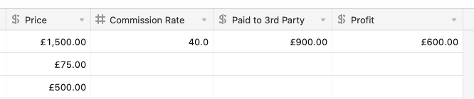

Looks pretty straightforward here but not sure how to implement in Airtable. I have attached a screen grab of the relevant fields. The first row has been manually entered to show what I want the formula to do!

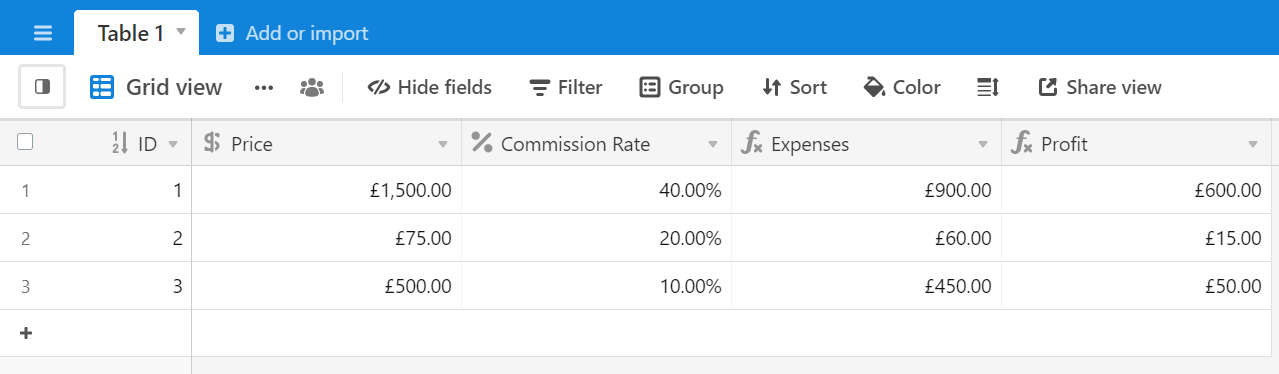

@Chris_Witham This is what you are looking for:
Notice that Expenses and Profit are formula fields.

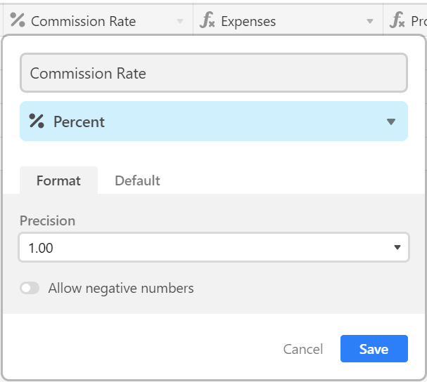

  1. I set the Commission Rate field to a percent as that is the value that you are entering.

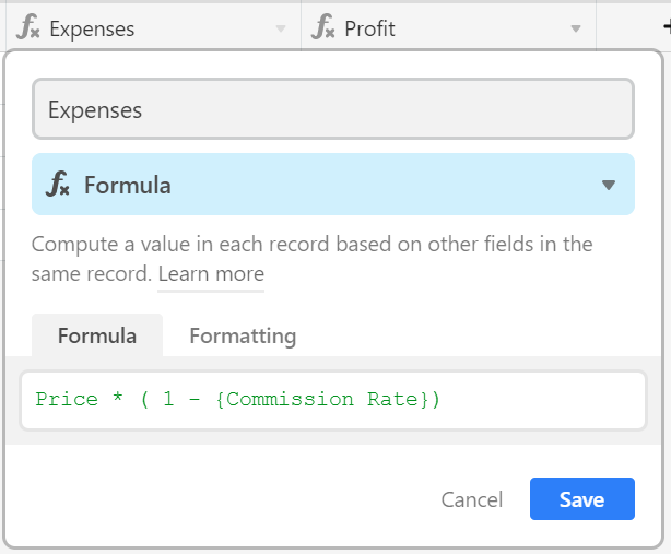

  2. I set the Expenses field (Paid to 3rd Party) to the following formula: Price * ( 1 - {Commission Rate})

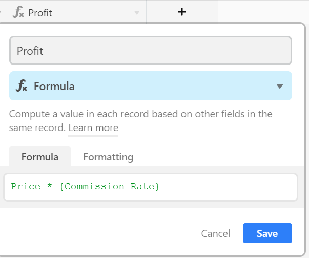

  3. I set the Profit formula to the following: Price * {Commission Rate}

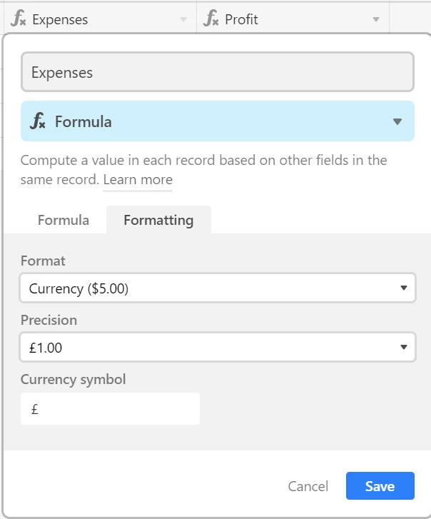

  4. I set the formatting on both the expenses and profit to be currency to match the proper type.
