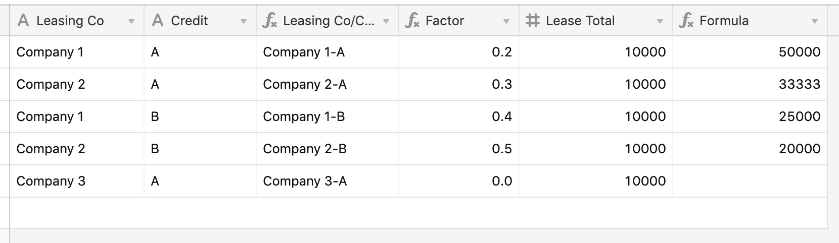

Hi @Neal_Fluhrer - not exactly sure what the problem is with your formulas as I haven’t tried to recreate them, but one suggestion would be to get rid of the long nested IF statement and replace this with a SWITCH:
In my example, I’ve created a field “Leasing Co/Credit” with the formula:
{Leasing Co} & '-' & Credit
The Factor field can now be greatly simplified:
SWITCH(
  {Leasing Co/Credit},
  'Company 1-A', 0.2,
  'Company 2-A', 0.3,
  'Company 1-B', 0.4,
  'Company 2-B', 0.4,
  0
You don’t have to worry about getting the nesting and matching brackets correct. If you get a new company or credit you can just add lines above the default return value of 0.
Now your formula field can be:
IF(Factor > 0, {Lease Total}/Factor)
