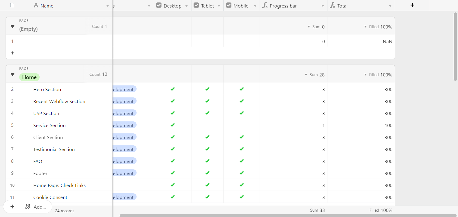

I want a percentage bar where if desktop, tablet and mobile is ticked then it will show full 100% filled percentage bar
Here’s my table link:
