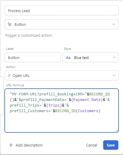

Hi!
I created a prefilled form link but somehow it’s not populating the field. I created other similar ones and those are working though. Help!
Working: Form
Not working: Form

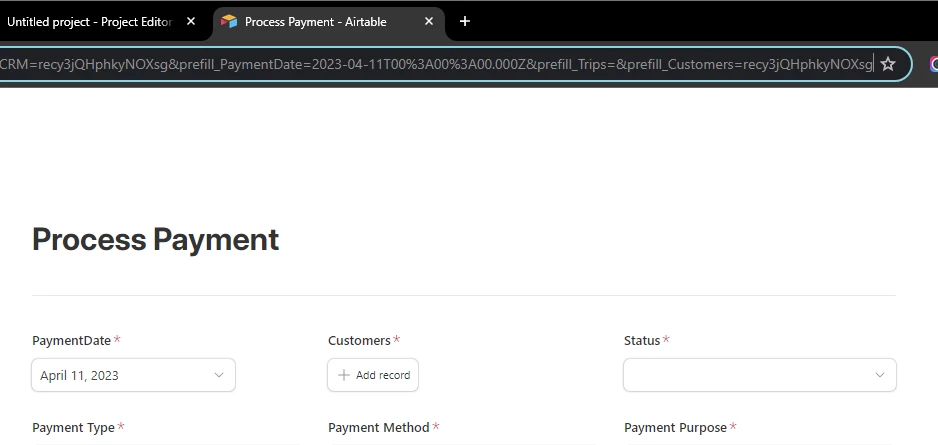

  • July 29, 2024
Update: it does work, but only sometimes as long as you are testing it in the same browser where you do the designing (Edge in my case). When I use the exact same link in a different browser where I'm not logged in it works fine.
Maybe a strange buffering / record caching issue? Or an Edge thing?
  • August 1, 2024
Confirmed here as well
@Tuur is correct. If using the link in a separate browser from the designing browser, it works fine. So the form prefill works for your users, but not you (at least initially). I have tested it with other users and the form prefill works fine for linked records.
