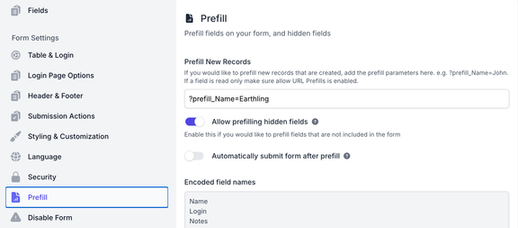

Hi there!
At miniExtensions, we've created a third-party form that integrates seamlessly with Airtable and supports default values, and offers advanced prefilling capabilities, such as prefilling hidden fields (the fields don't have to be part of the form's structure or its URL) or automatically submitting the form after prefilling, which is ideal when you need to add extra information to your existing workflow (e.g., capture IP address or location data):
Feel free to explore these features and many more with a free account on our site.
