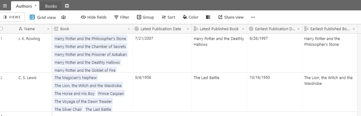

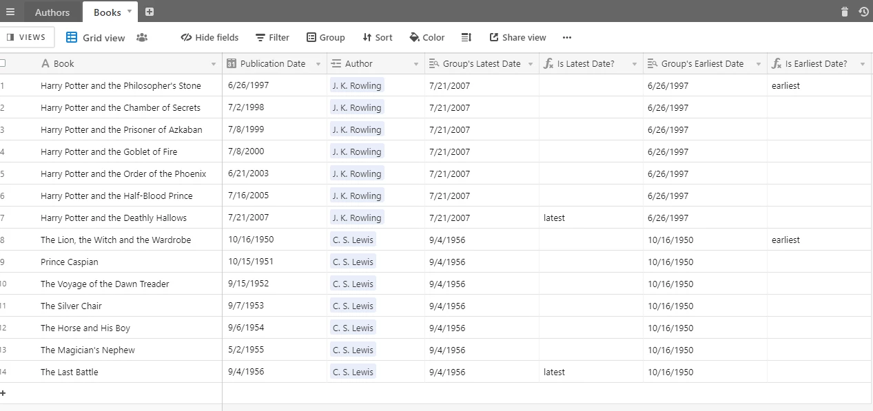

This can be done with a system of rollups, lookups, and formula fields. No scripting required, and the order of the linked records doesn’t matter.
In the parent table, use a rollup to identify the latest date. In the child table, use a lookup to see the latest date for the set and compare that date with its own date to see if it is the latest. Finally, have the parent table use a conditional lookup to show only the latest of its children.
Here is a sample that shows both the earliest and latest linked records.
The parent table (Authors)
The child table (Books)

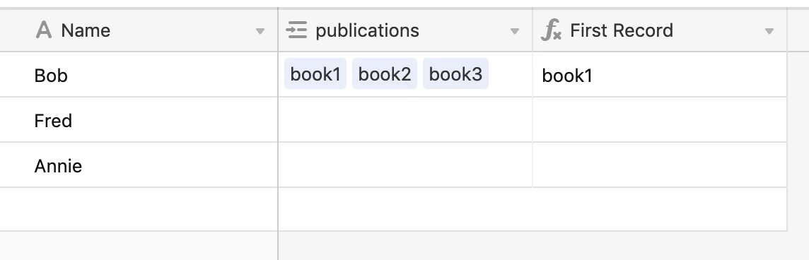

That’s a tough one. Not a great or complete solution here, but here are some thoughts. I know you can pluck the first record from a list of linked records like this:
LEFT(""&{publications},FIND(",",ARRAYJOIN({publications}))-1)
But the order of the linked records matter then. For that, you might be able to use something like batch update as recommended by @kuovonne
