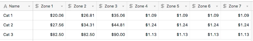

Thanks for the clarification. That difference between flat fees vs per-mile fees is good to know, and will actually make the resulting setup easier. Here’s what I came up with. First, I made a [Rates] table:

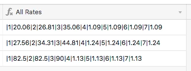

To that table I added a formula field that concatenated all of the rate values, prefixing each one with a special marker corresponding to its zone. I’ll explain the purpose of this later. For now, here’s how the field looks, along with its formula:
"|1|" & {Zone 1} & "|2|" & {Zone 2} & "|3|" & {Zone 3} & "|4|" & {Zone 4} & "|5|" & {Zone 5} & "|6|" & {Zone 6} & "|7|" & {Zone 7}

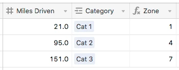

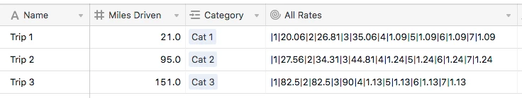

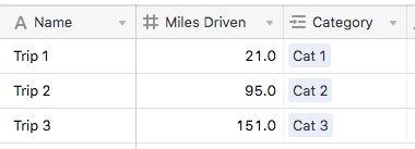

Next I made a [Trips] table, where I entered the mileage into {Miles Driven}, and linked to a rate category from the [Rates] table.

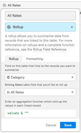

I then added an {All Rates} rollup field to pull the mashed-together rates based on the link. (This will be hidden in later screenshots.)
I made a {Zone} field to calculate the zone based on the miles driven. Because the zones are based on multiples of 25 miles, this was fairly easy. The MIN() component ensures that the zone will never be greater than 7.
IF({Miles Driven}, MIN(ROUNDUP({Miles Driven} / 25, 0), 7))

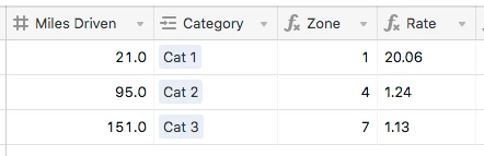

Now that the zone has been figured out, the rate can be extracted from that mashed-up string using this formula in a {Rate} field:
    Zone,
    MID(
        {All Rates},
        FIND("|" & Zone & "|", {All Rates}) + 3,
            Zone = 7,
            LEN({All Rates}) + 1,
            FIND("|" & (Zone + 1) & "|", {All Rates})
        ) - FIND("|" & Zone & "|", {All Rates}) - 3

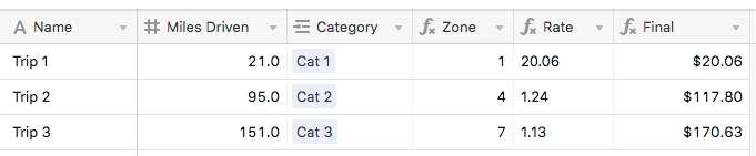

One more formula field (formatted as currency) does the final calculation:
VALUE(Rate) * IF(Zone > 3, {Miles Driven}, 1)
