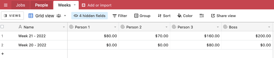

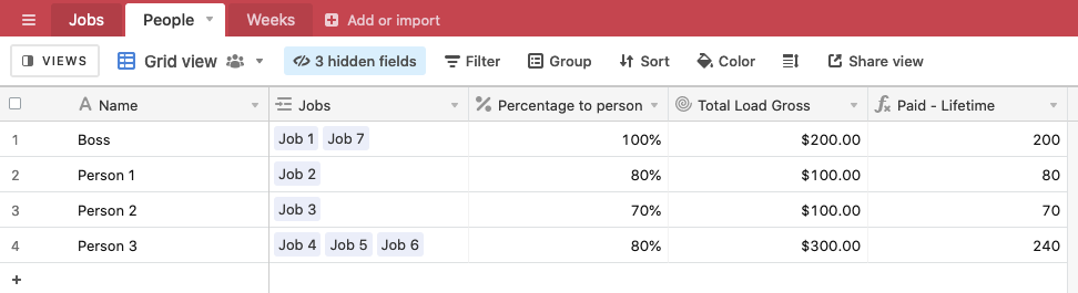

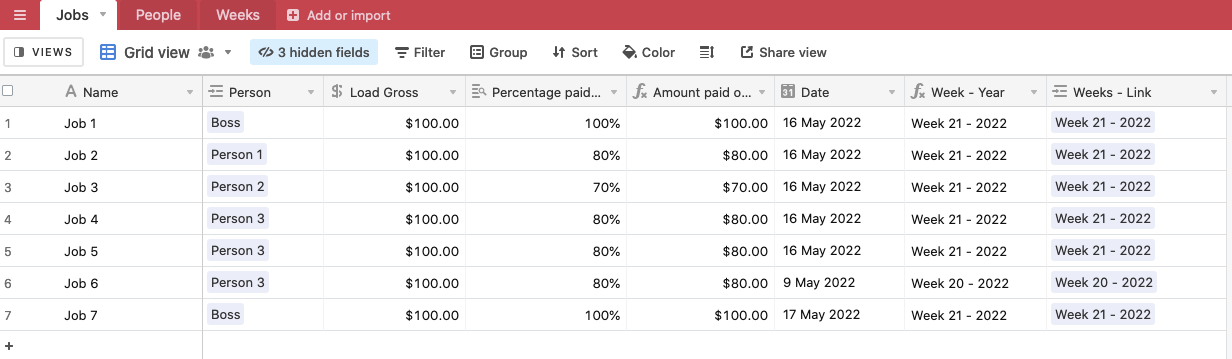

The idea is we’ll make three tables:
  1. Jobs - Containing information on the jobs taken such as the load gross, person assigned, and the date of the job
  2. People - Containing information on the people in your company, including how much % they get of each load gross
  3. Weeks - Links all the jobs in a particular week - year together. (I included this just because it seems like something you might find useful)
And so the workflow would be:
  1. You set the % of the load gross each person gets in the People table
  2. You create records in the Jobs table with all the information mentioned above
  3. Every week you go into the Weeks table to view the weekly summary.
With reference to point 3, you’re either going to have to paste the Week - Year value into the Weeks - Link field every time you create a new Job, or use the automation that I’ve set up in the base linked above.
If you do end up using the automation I set up, I’d recommend you create job records via a form. This is because the automation is triggered when a new record is created, and so might not run properly if you don’t create job records via a form.
You can probably end up doing some cool stuff with the Weeks table, including sending out email invoices and such with the summarized information. Let me know what you think!
