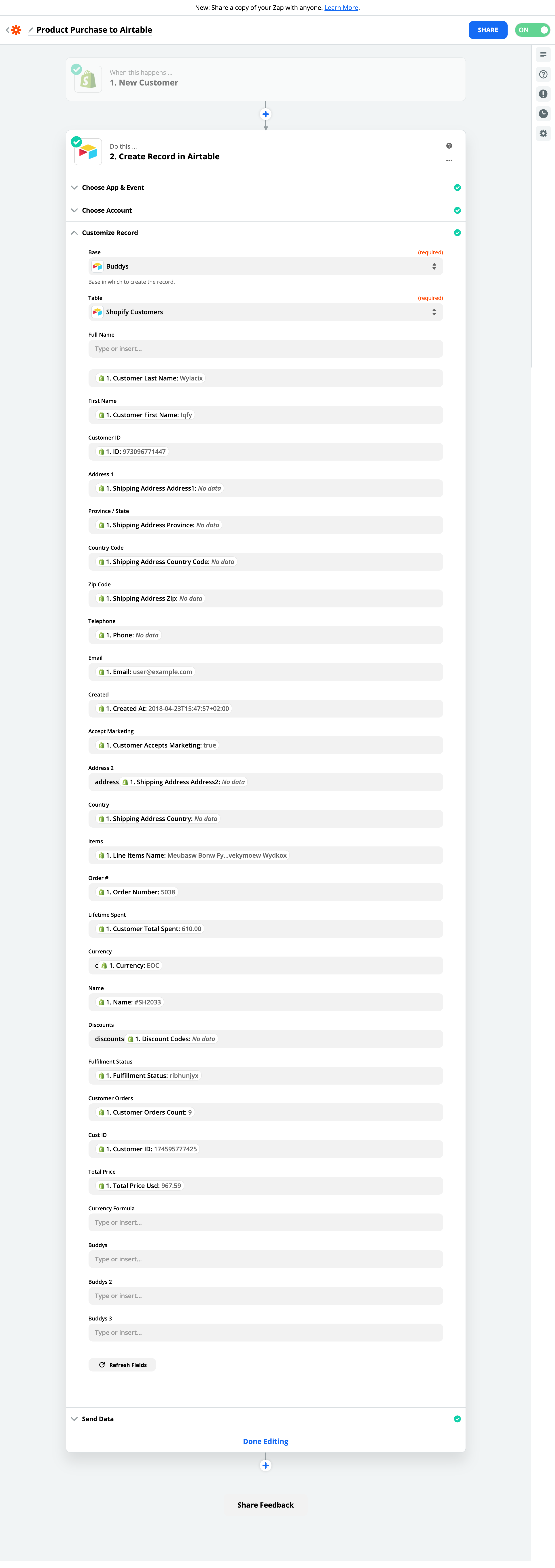

Hello lovely Airtable Community. I’m building a CRM system - I have full profiles built for leads from Instagram and Facebook in one table. I have just added a new table inside the base and I am sending information from Zapier to Airtable for customer purchases. Does anyone know how I can look up / roll up the information so that the products and the amount spent in the Shopify table show up in my original CRM table? I hope this makes sense! Thank you so much

Thank you so much for your help Justin. I’m so sorry but I’m not entirely sure what you mean by “have Zapier make a link”
I’ve attached my Zapier set up in case it helps point me in the right direction.

@Celina_Rollon, it sounds to me like you probably haven’t setup any linked record fields in your Airtable base yet. Once you setup your linked record fields in your Airtable base, then Zapier can simply set those fields as if they were any other normal fields in your system.

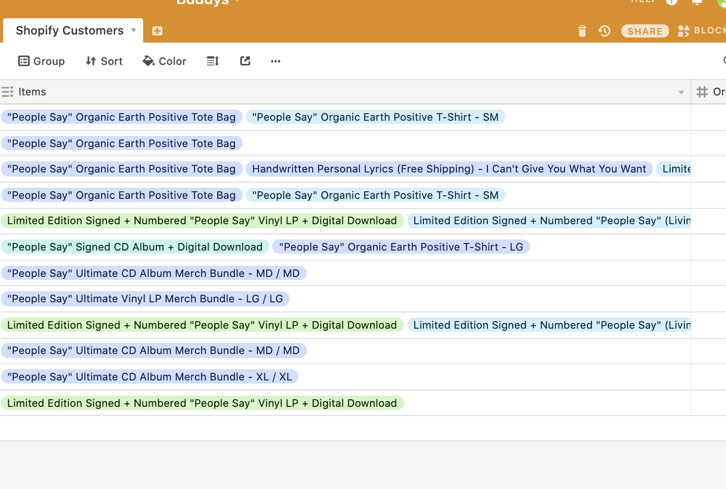

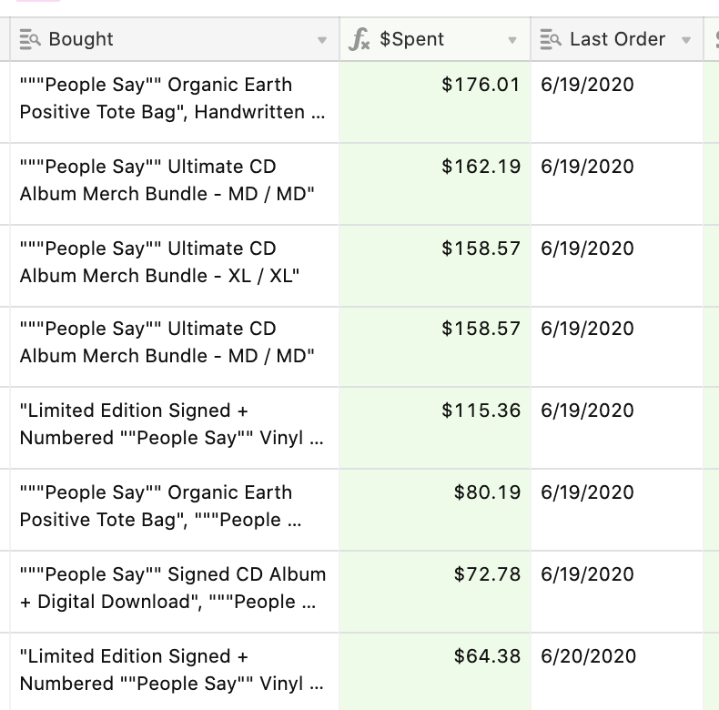

Thank you both so much. I have a linked field (I linked full name in the main lead table) but I have to type their name in to that linked column then it pulls it up all the names and I select which one . Then in the lead table I have made a roll up of amount spent then products. Is that as automated as I can get? Also the product roll up looks a little messy. Is there anyway to have a multiple choice show up like what I have in my Shopify table? The first photo is the items inside Shopify table. The second is how the roll ups look like?
