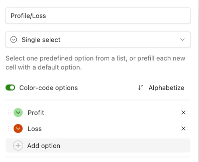

Adding one question since I'm here already... in my case I'm differentiating between incoming and outgoing receipts and then subtract the sum of incoming from sum of outgoing. So if the result is positive, there was a profit, if its negative, there is a loss.
Is there any way to color this one particular cell with the result?
I only found the option to color the whole project row (the little dot in front of the name field)
Ahh, at this time I don't think so I'm afraid
Dan_Montoya
I would use an automation that sets a field that is a single select.  Profit is green and loss is red
