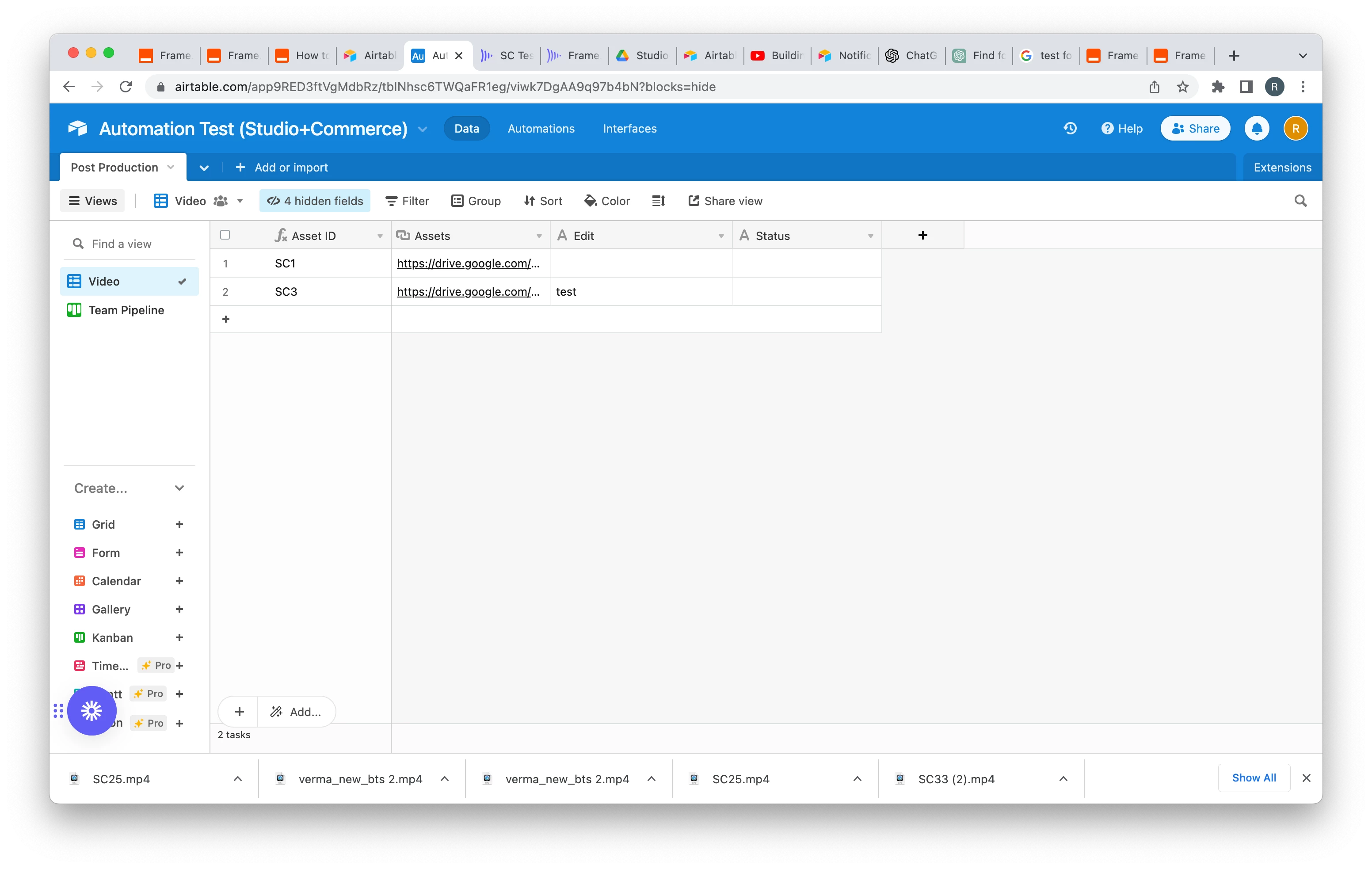

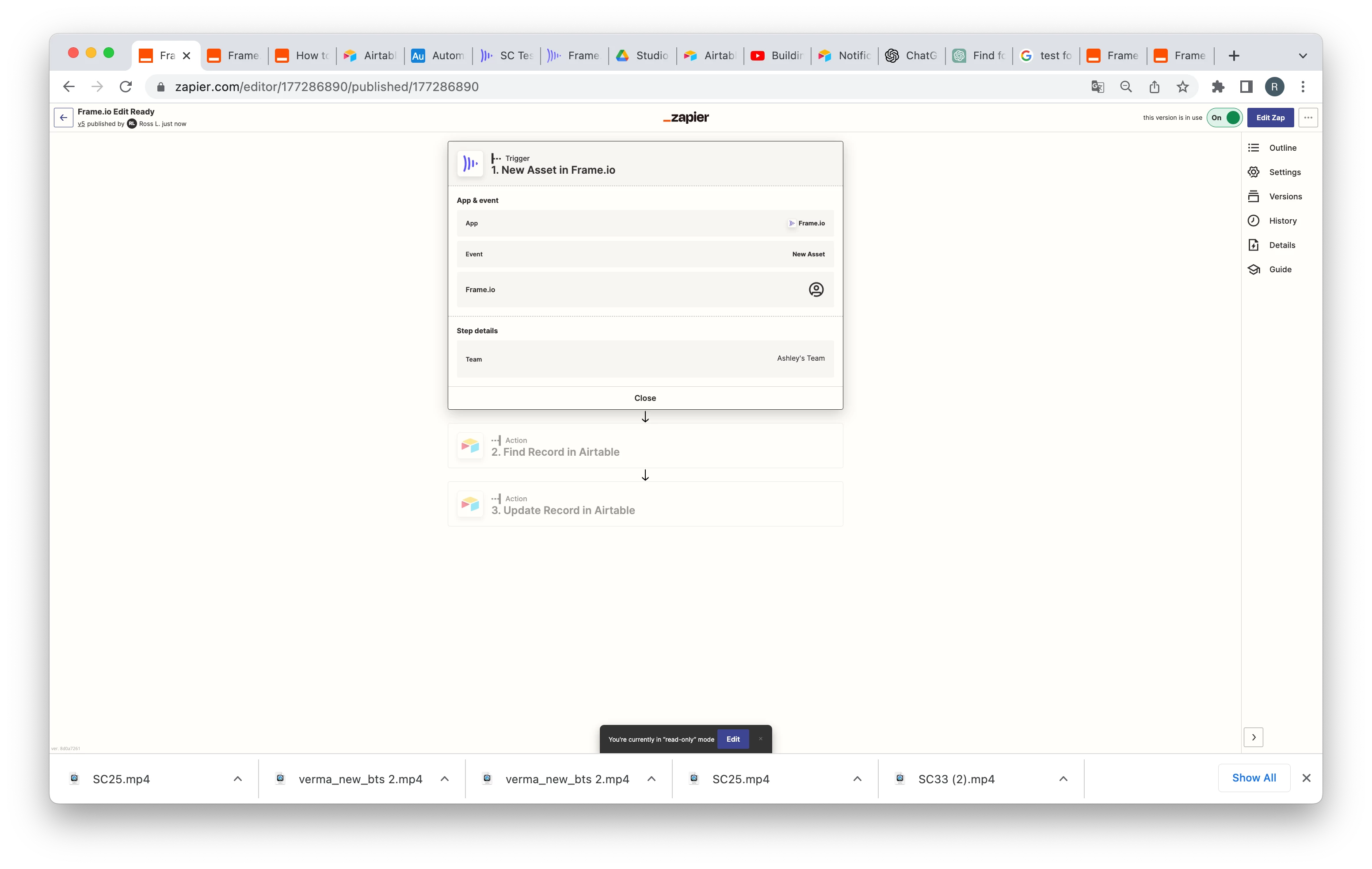

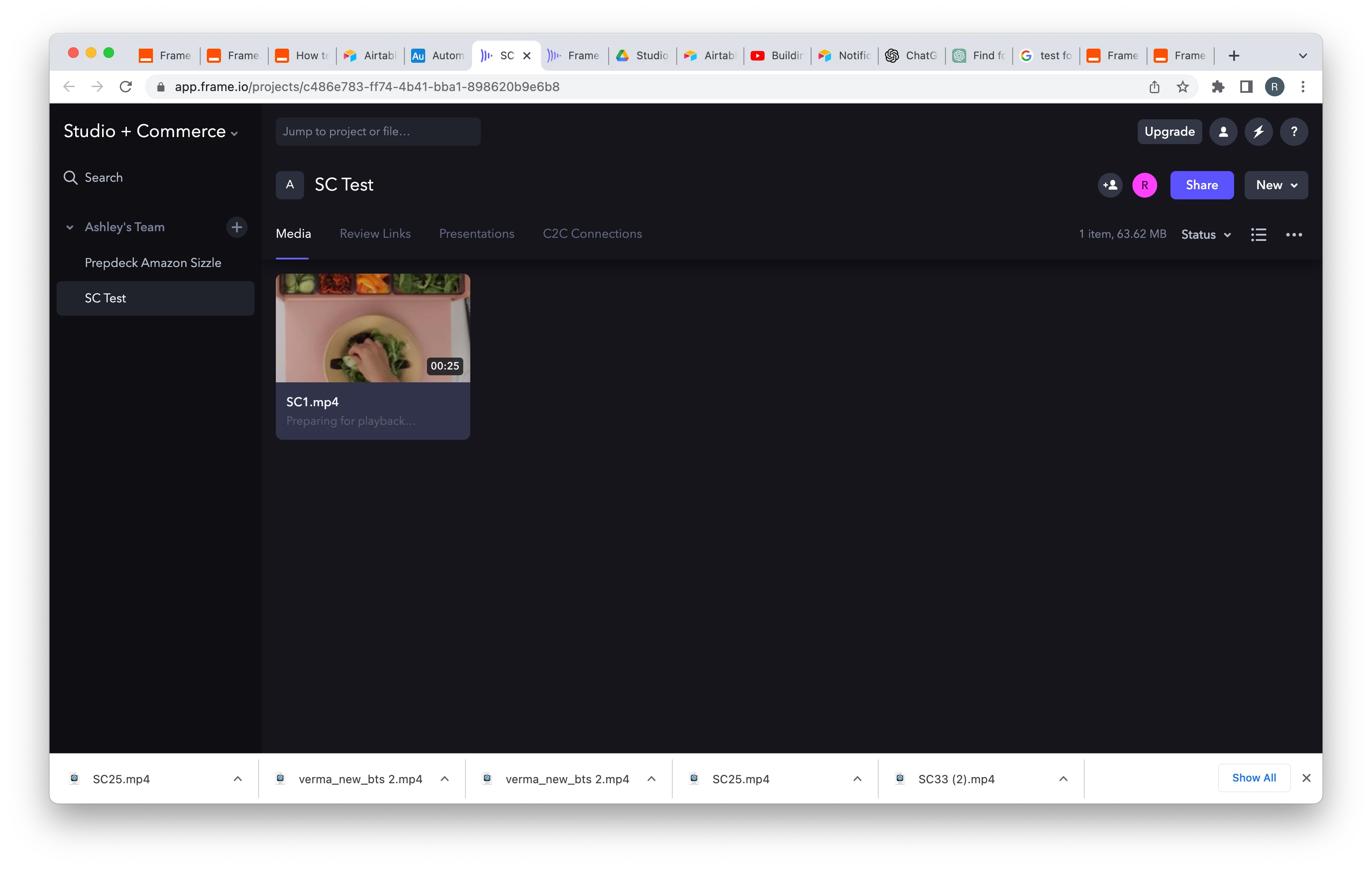

  1. Uploaded video To frame.io where the name of the video is the same as a Unique ID in airtable ( called Asset ID ) in Airtable
  2. search for a field ( Video Edit )
  3. Input text or link  to inform that video has been uploaded

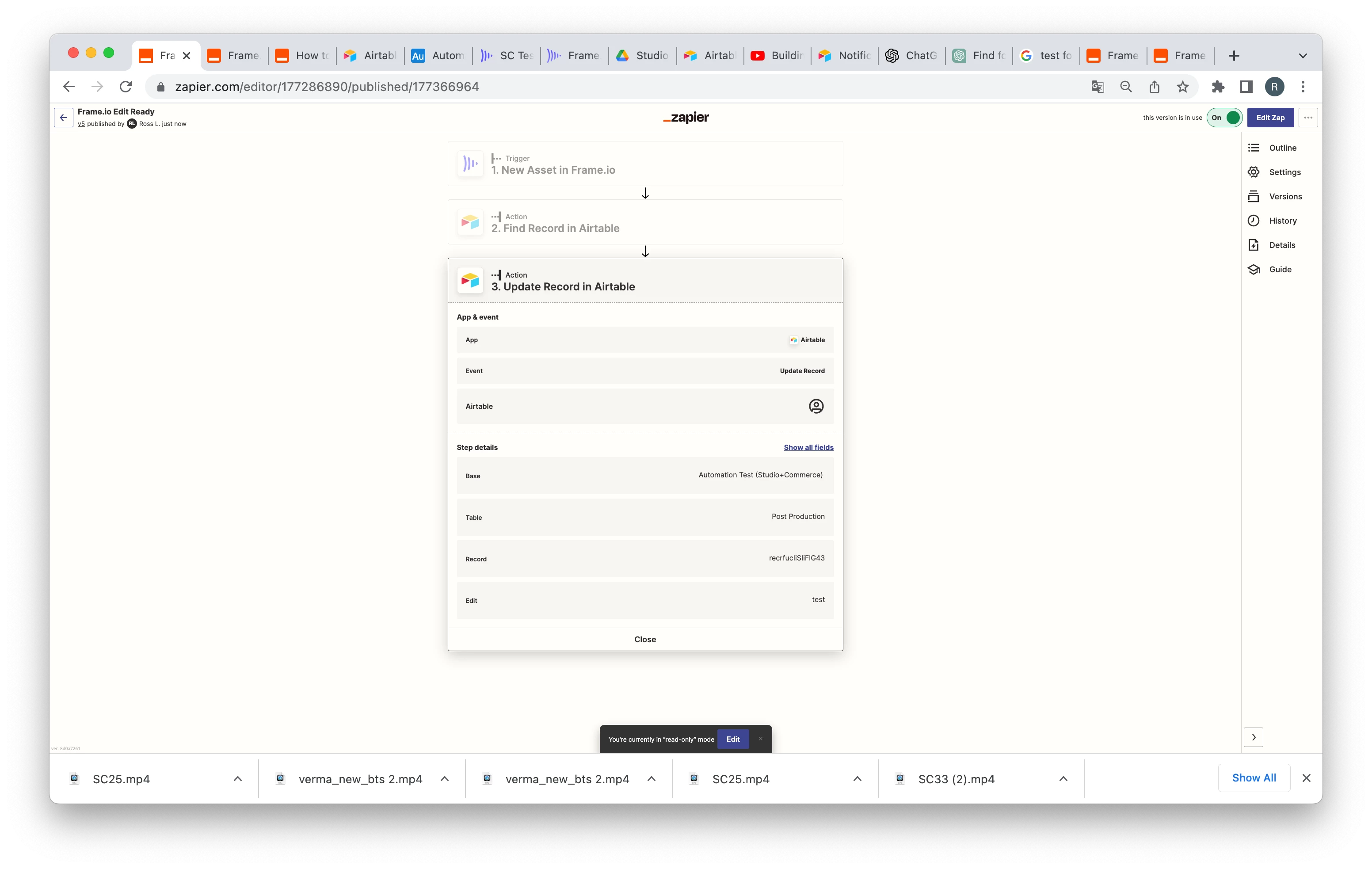

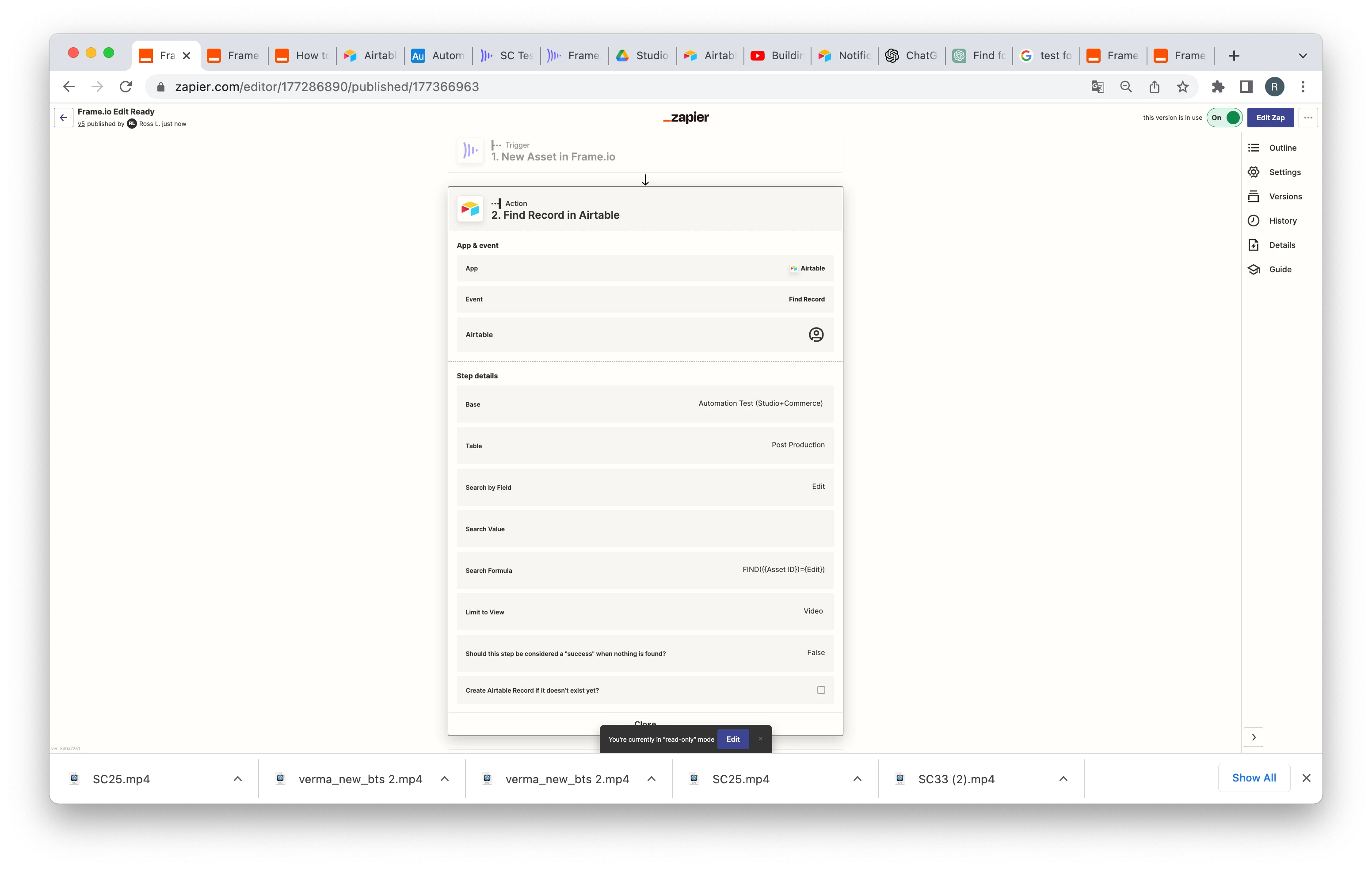

I have tried to find the record using a search function and my zap looks ok but when i run it it does not update to the correct field.
when i test the last part of my zap ( input text ) it will only place it in the first record and not the one attaching the unique ID
i have tried the following SEARCH functions also FIND
SEARCH(({Asset ID}))!={Edit}
SEARCH(({Asset ID})) = {Edit}
not sure if it is that or when i go to set up my action in the RECORD section i am picking the wrong dropdown.
i thought it may be “custom” “zap search was found” but didn't work , and i have also tried multiple other options

Hey Adam , ill check that link and look to book something next week after the holidays if i cant figure it out over the weekend 🙂 here are the screen shots - i think my search formula is wrong as i cant link / map the record ID in later steps 😞

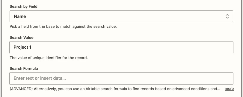

Ah, I think you can just leave the "Search Formula" bit of your Zap empty actually.  As long as you're searching the "Asset ID" field by the asset ID value, it should get you the result you're looking for

yeah i got it sorted thanks adam - cheers
