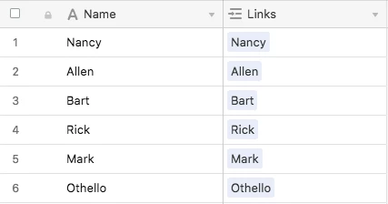

After an event, I get a list of attendees, and drop that into an [Attendees] table for processing. Some of these are members, others aren’t, and not all members attended the event.

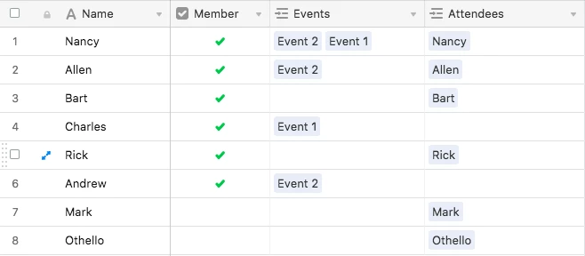

After putting all of their names into the primary field, I copy them to the next field over, then convert that field into a Link type, pointing it to my [People] table.
Now my [People] table looks like this. I can easily tell members from non-members, and can also easily see who attended the new event.

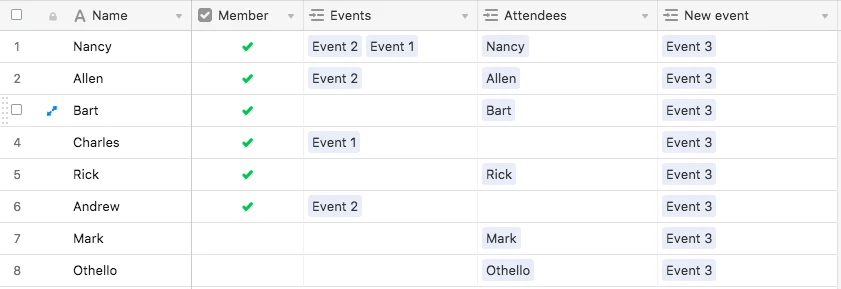

Now I add (or un-hide if already added) a Link field that points to the new event in the first record, and drag-fill that so that every record has that link.

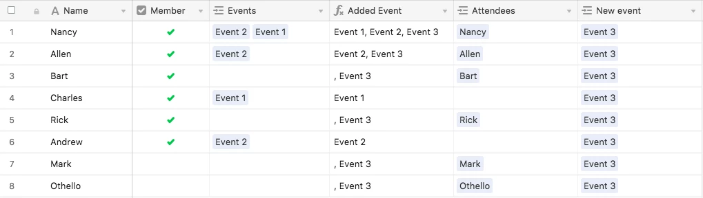

That’s the link that I want to add, but only to those who attended, which I can see in the linked {Attendees} field. With that, I can build a formula field that adds that new event to the existing events for all attendees:
Events & IF({Attendees}, ", " & {New event})
The full table with that field added now looks like this:

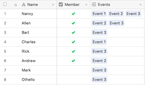

Now I can copy the contents of the {Added Event} field across all records (click the field header once and the entire column will be selected), and paste it into the {Events} field, which will a) keep the existing links, and b) only add links to Event 3 for those who attended Event 3. Once that’s done, I can hide the extra fields, and I’m left with this:
I can then reuse the [Attendees] table for the next event.
