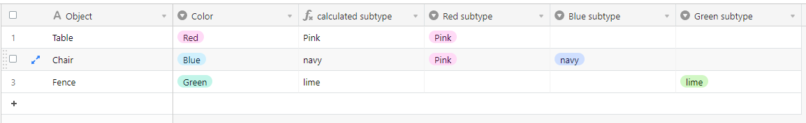

If you have a relatively small number of options in “primary category”, you could workaround this by building a separate column for each type of subcategory:
For example, suppose your primary category options are Red, Blue, and Green.
Then you could create a “Red subtype” column, a “Blue subtype” column, and a Green “subtype” column. You could add a Formula column that shows the value from one of those three columns based on which primary is selected.

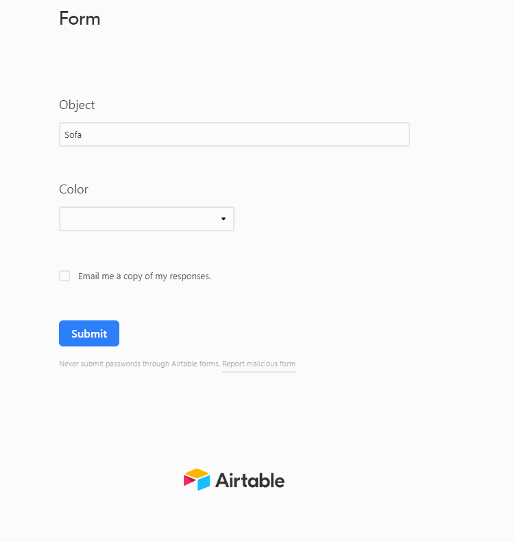

You could also build an input Form that hides or shows each subcategory field depending on what is in Primary category. So if you chose the Red primary category, the form would hide the Green and Blue subcategory fields and only show the Red subcategory fields.
Here’s what the table would look like:
and here’s the conditional form behavior:
