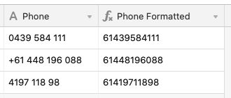

Here’s a formula that should do the trick:
IF(Phone, REGEX_REPLACE("61" & REGEX_REPLACE(REGEX_REPLACE(Phone, "\\D", ""), "^0", ""), "^61614", "614"))

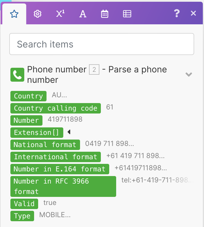

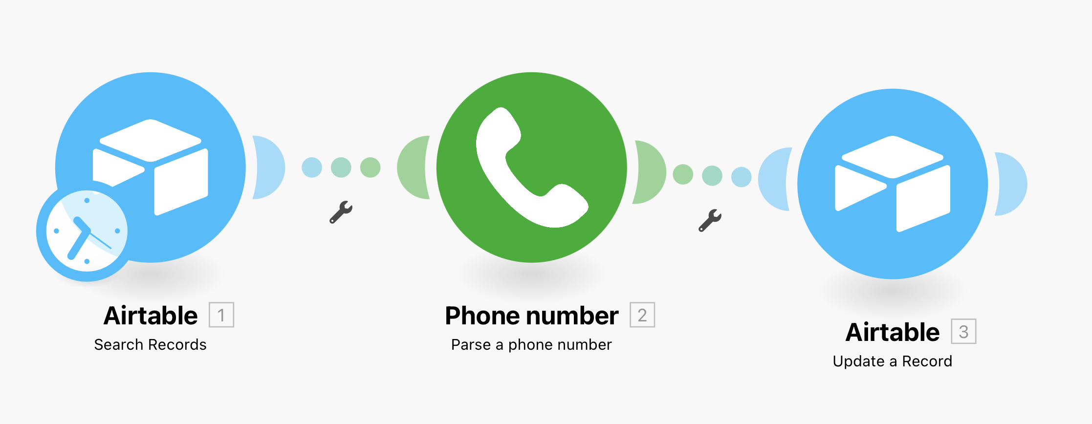

I’m posting this primarily for my own future reference, but Make.com has a built-in Phone Number parsing tool, which can parse a phone number in a variety of different ways (see screenshot #2 below), based on the country that you specify.

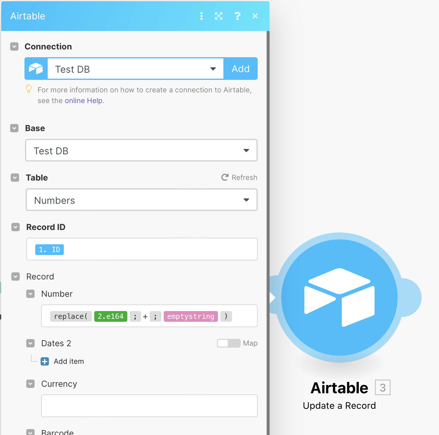

However, it always leaves the plus symbol intact, so you have to remove the plus symbol using the replace function (see screenshot #3 below).

I tried this in Make.com using all of the sample phone numbers that @Kosta_Kondratenko listed, and it worked perfectly! :grinning_face_with_big_eyes:
