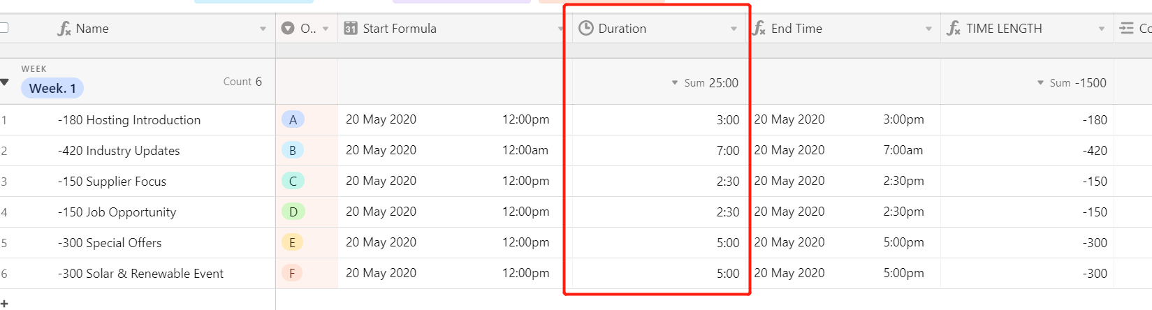

Hi everyone :slightly_smiling_face:
I’m very new here and I’m still trying to learn this immense platform.
I just attached the image of what I am working on.
I would love Airtable to pick up the duration of each topic and update the start and end
For example “hosting introduction” is 3 mins, starts at 12:00pm and finish at 12:03pm The next topic is “industry updates” and it will last 7 mins starting from 12:03 til 12:10.
Does anyone know a formula that will calculate the time?
Thank you so much to everyone who will read this :grinning_face_with_smiling_eyes:
15 replies
Forum|alt.badge.img+14
Welcome to the community @Diletta_D_Arrigo!
You should be able to use the following formula to do exactly what you’re looking for:
DATEADD({Start Formula}, Duration, 'seconds')
This will add the duration to the start formula to calculate the end time. Do keep an eye out that the formatting between the different columns is the same. You may get wonky-looking results if one is on 12 vs. 24-hour time or GMT vs. your local time zone.
If this answers your question, please consider marking it as “solution”. If not, I’m happy to work with you further. Thanks!

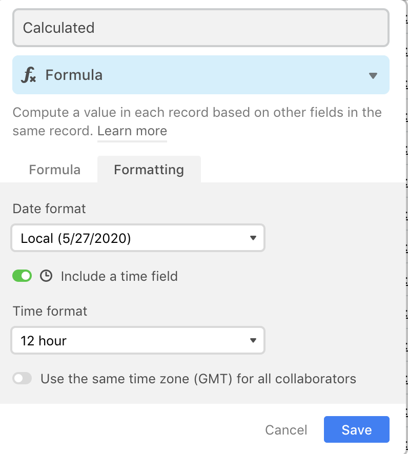

Thanks for this response. Would there then be a way to make the next event (record) start at the time the last event ended? I’d like to enter a start time for the first event, and have all subsequent events’ start times determined by the duration of the events prior to them. Thanks!
Welcome to the community, @Viveca_Gardiner! :grinning_face_with_big_eyes: I helped another user with a very similar use case recently. While this isn’t possible using formulas, it can be done using a script. Here’s what I came up with…
Thank you so much, but I’m afraid I can’t follow this at all. I am new to Airtable and don’t know anything about coding. So if the answer is that I can’t do it, I can’t do it. Which is horribly less convenient than a spreadsheet for this key need as I am trying to plan a day’s itinerary for an online event in which each event immediately follows the one before.
But this seems particularly frustrating since the example includes a column called “Previous End,” which implies that it is populating with the previous event’s end time. If I could do that, my problems would be solved with just the formula you provided for start time:
IF({Item#} = 1, DATETIME_PARSE("START_TIME", "START_TIME_FORMAT"), {Previous End})
If I used this, can you please tell me what would replace
DATETIME_PARSE(“START_TIME”, “START_TIME_FORMAT”)
if I wanted the first time to show as just
12:30 pm
From your links, I thought it would be
DATETIME_PARSE("???", “LT”)
But I couldn’t figure out what to put for the question marks.
Thank you!
Viveca

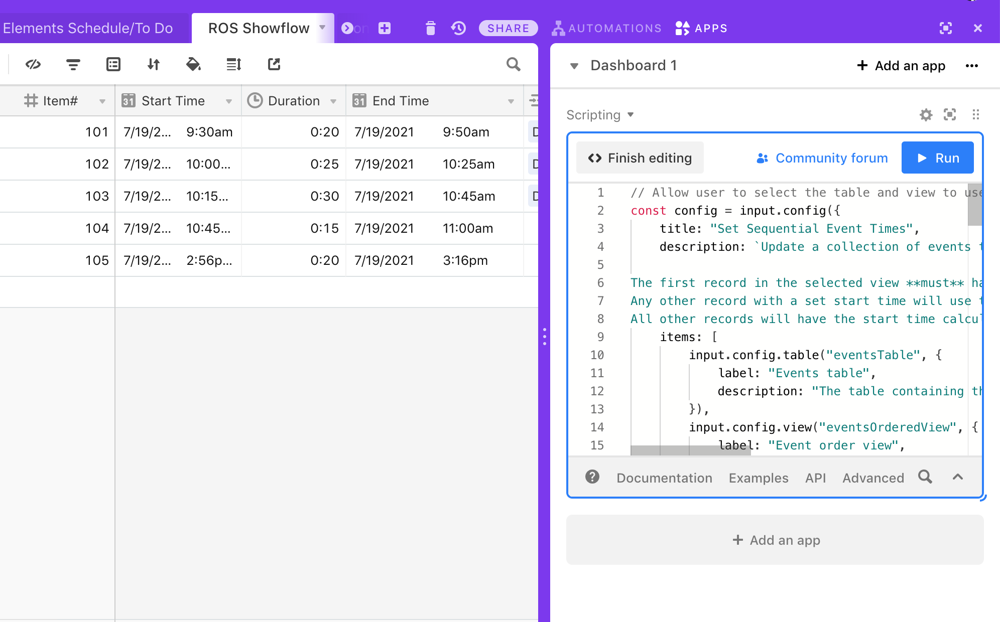

Hi all! I was also trying to do this type of time duration to create a Run of Show for a live event. I’m trying to figure this out and work with the script above but I’m not getting it :frowning:
I have the columns: Start Time (Date/time field), Duration (duration field), End Time (Date/time field)… but the end time doesn’t go down to the next row to use that as the start time.
Any help on this? Thanks! :slightly_smiling_face:
This is pretty much the same script as in the other thread that I just replied to, but this one has a more friendly UI so that you don’t need to manually change the code to enter your field names.
Please share a screenshot showing your table as it’s set up before running the script. Something tells me this will provide some useful clues to why it’s not working for you.
Pam_Elliott1
I know… was trying hard to figure out using the other script you had… it seemed to work. But only thing it doesn’t do is then put the end time from the top row to the bottom and cascade it down.
Here is the screenshot
Thank you Justin for helping on this!
Pam
Pam
In my original instructions, I mentioned that a fixed date/time in the “Start Time” field will always be accepted as-is, and not overridden by the previous record’s end time. What you need to do is erase the start times for everything except the first record. Re-run the script, and it will fill those other start times based on the duration calculations.
On a related note, I submitted my script above to Airtable for inclusion in the scripts marketplace back at the start of April, and I haven’t seen it appear there yet, so I’m not sure if it’s going to ever show up. At any rate, part of the submission was to include a video showing how it worked. Maybe this will make its intended use more clear:
I’ll try to keep this video alive as long as I can, though I’ll probably end up recording a new demo to put on my YouTube channel eventually.
Pam_Elliott1
oh wow - I’m a total idiot. Yes it totally worked once I deleted the old info from the other records below the first start time! Awesome!! THank you so much Justin!
In case anyone else finds this thread and not the one where the script originated, there’s now a new thread where I’m planning to post updates and address support questions going forward. Within a day or two, I hope to update that thread with a version that will work in an automation.
