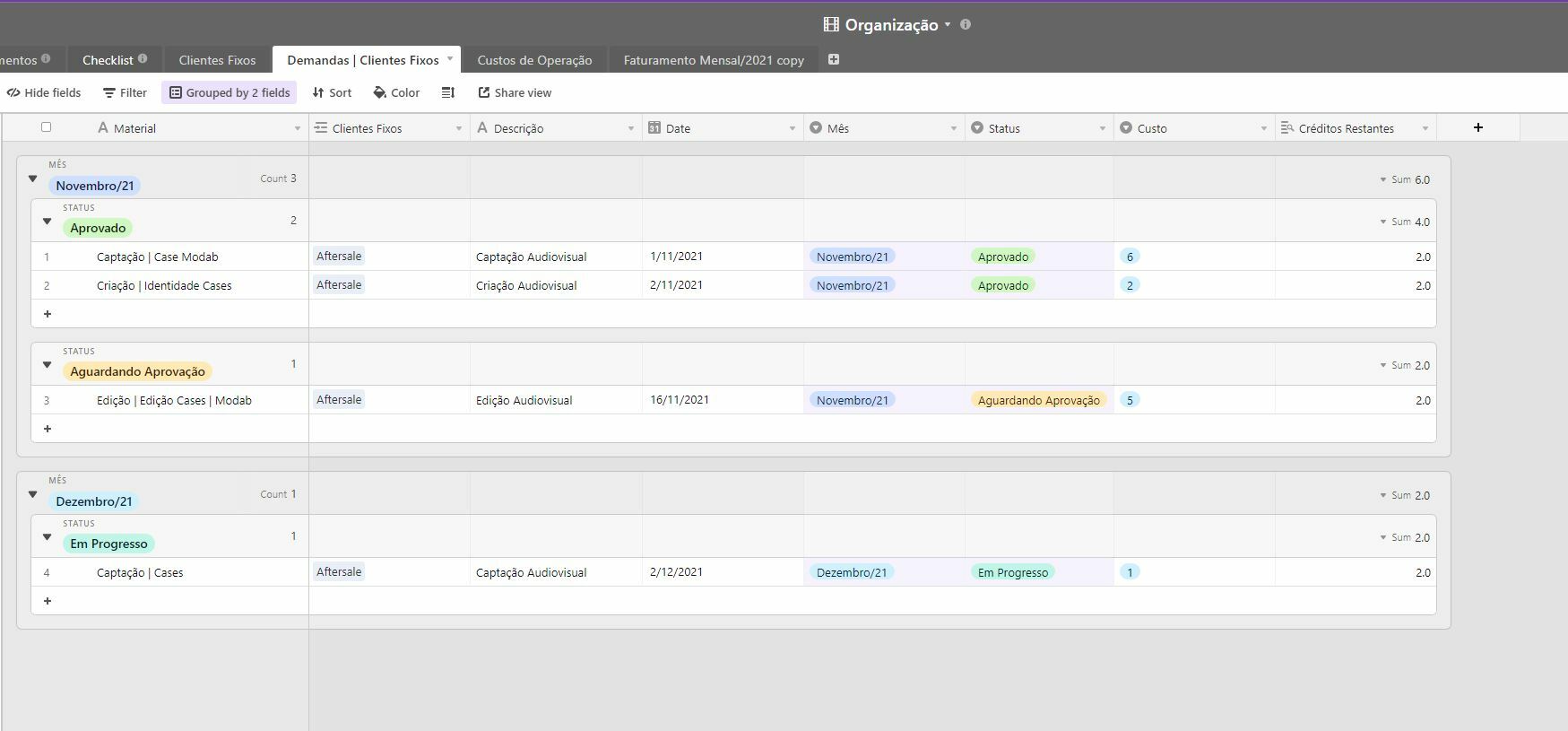

I have attached a photo of how the project is currently set up, I think it might help to visualize what I want. Note that currently the “Total Credits” column is being manually updated, so the values ​​in the “Remaining Credits” column are correct.
Sorry about the mess.
Thanks in advance!

Therein lies the rub. Airtable formulas only have access to the values from a single record’s fields. That means if you want to use values from another record, you have to link those records together and use Lookup (or Rollup) fields.
Now seeing your data structure, It seems like you should have a table for Clients, and whatever table you’ve screenshotted should link to it. Instead of retyping Client 1 over and over, you’d have a single record in the Clients table for “Client 1” that each relevant request links to. Additionally, using single select field for the Month will essentially limit you to only organizing data for a single calendar year (what happens when you get to November 2022?).
It is unclear whether Clients’ credits rollover each month or if credits expire at the end of the month. This distinction will affect the best possible database setup.

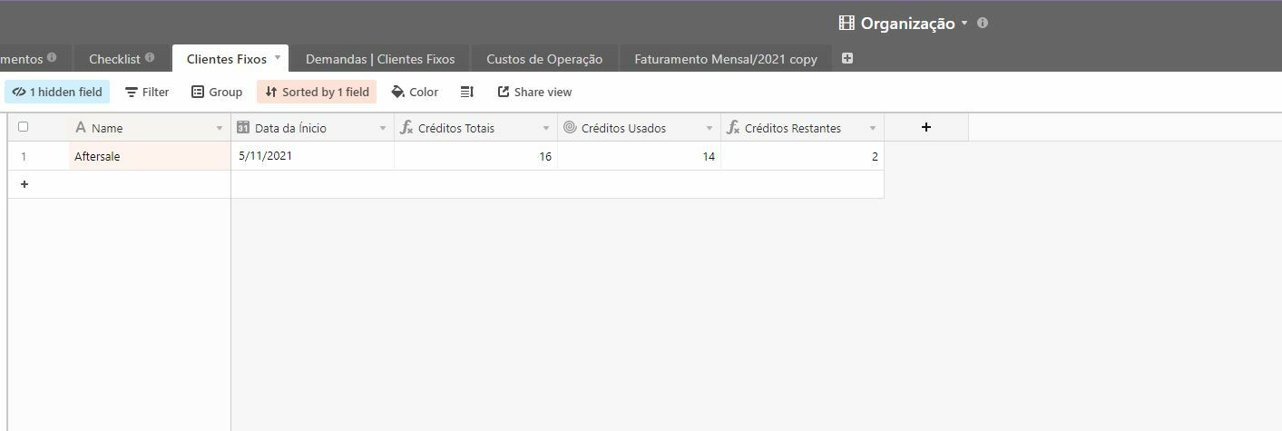

Thank you very much, Kamille!
Your suggestion worked perfectly!!
Sorry for the delay to return, I was only able to test now. So far I’ve only added one client to test, but I’ll do it for everyone now.
I would like to take this opportunity and clear one more question, it is not so essential, but if it is possible to make it work, it would help me a lot too. Would it be possible to create a column with credit history? For example: On 11/15/2021 the client requested a job “recording | cases”, then I define the cost of this job in the column “Cost in Credits”, then automatically I will have the amount of credits remaining in the column “Credits remaining” . Does the amount of credits he had that day remain in a column like “Credit History”?
I don’t know if it was very clear, the idea is that this column works exactly as a history, recording the amount of credits he had on the day he requested this work, already taking into account its cost.
Thank you very much for your attention!

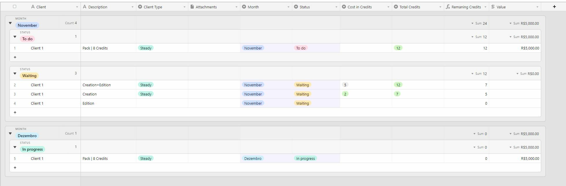

PS: I’ve attached some photos for you to see how the organization was and make it easier to understand. Do you think it was well optimized?

If you need to record running history like that then you need an Automation. Set the trigger for when record matches conditions where: {Client} is not empty, and {Cost} is empty. Then use an Update Record action to copy the value of the {Credits Remaining} lookup field into the {Credit History} field. This will only work for records going forward, you’ll need to fill in credit history for records already in the table.
