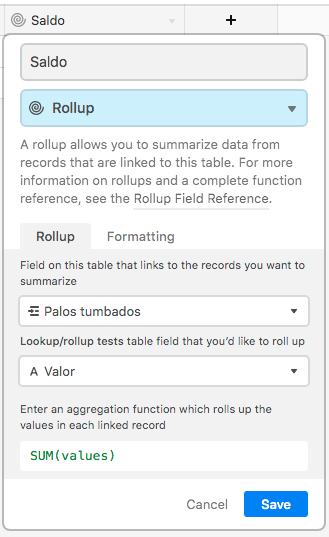

To your question, you would normally use a rollup field to summarize values from linked records, and technically this could be done with your existing design. However, I strongly suggest changing the design of your [Palos tumbados] table (I hope I read that name right; the JPG compression is making it tough to read it). The data in the primary field of a table is supposed to be unique for each record, but you’ve got several instances of repeated numbers in the primary field values of those linked records. I’m guessing that you’re using a formula to build that value, so my first suggestion is to put that formula into another field (I’ll call it {Valor} for this example) and change the primary field formula so that it creates a unique value. With that done, your {Saldo} field would become a Rollup field, setup like this:

I’m talking about the primary field in the [Palos Tumbados] table:
Those scores are the numbers that I’m assuming are created by a formula, and as I said before, I suggest moving them to a different field. The primary field isn’t the place to keep the score for the round. The score should be in a separate field, with the primary field used to label the round; i.e. Round 1, Round 2, etc. Then use the {Saldo} field to roll up the scores from those linked records, targeting your new score field instead of the primary field.
