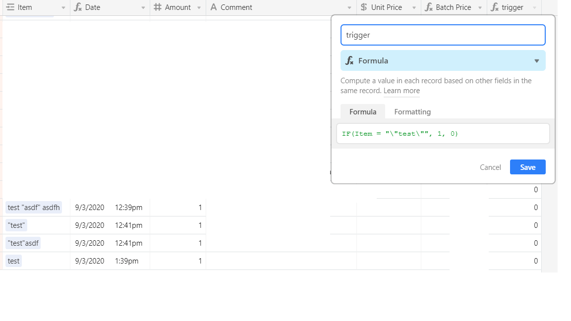

To clarify it further with a picture :slightly_smiling_face:
no matter what combination of quotes i use (and also escape character), it doesnt recognize any string with quotes INSIDE of the string
Your formula is actually fine.
But here’s the problem… your formula is referencing a linked record field, which can never really be done successfully in Airtable. There are lots of strange things (bugs?) in Airtable regarding formulas referencing linked record fields in Airtable, but the strange thing that you’ve stumbled upon today is if your linked record field has any quotation marks in it, Airtable ends up substituting 3 quotes for each single quote. But even after knowing about that, it’s useless knowledge, because as far as I know, you still can’t reference it in a formula field. Airtable is filled with weird inconsistencies like this, so this is not the only part of the product that makes little sense. Part of the “joy” of working in Airtable is trying to workaround issues like this. :crazy_face: :man_shrugging:t2:
Your solution is to create a lookup field. Create a lookup field (based on the existing linked record field), and pull in the item name into the lookup field. Then, your formula above should be changed to reference the lookup field instead of the linked record field, and that will give you the results you’re looking for.
